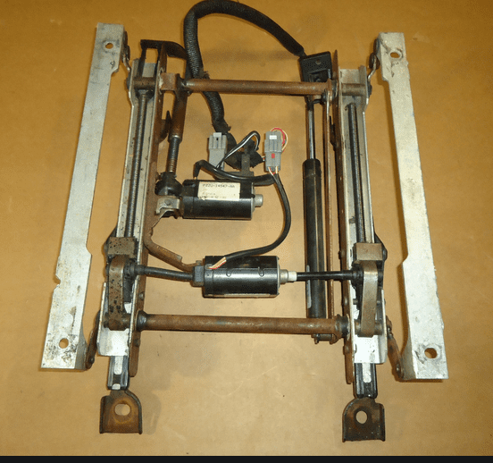

I ordered a power seat frame assembly online and installed it under my Barracuda seat frame. Now I have plenty of tilt on the upright part of the seat and tilt on the seat itself. Tons of front to back movement. The factory "pull lever" mechanism still works too!! It was so long ago I can't tell you who I bought it from but with the internet it shouldn't be a problem.
I bought something like this but it was generic not Mopar and not nearly as expensive.
2001-2003 Dodge Durango Seat Adjuster, Driver, Power 5066168AA | Mopar Auto Parts Direct

Not sure if this is the same as mine but I did buy it from ebay. It was many years ago so I can no longer looking it up in my past purchases:
seat lift kit | eBay
Just make sure you get one that's close to the correct width?

Just go to a junkyard with some measurements and find ya one for 20 bucks.
