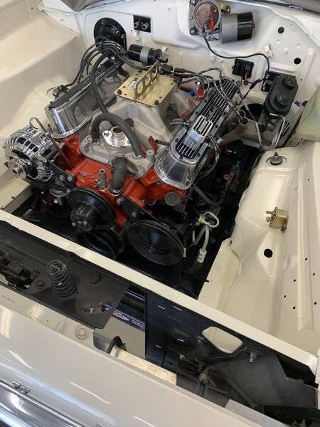

Here’s a Saginaw pump in a 67 barracuda, I did have it tweak the high pressure line a bit.
