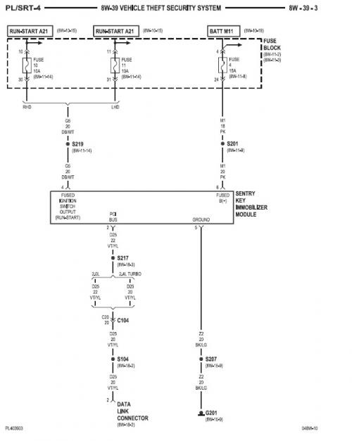

Well,Nigel would like for me to run the stock PCM. how ever my concern is getting around the skim. I have the handdeld dioblo tuner I bought from Nigel. I also have the PCM and skim with keys and a stock harness.

Well,Nigel would like for me to run the stock PCM. how ever my concern is getting around the skim. I have the handheld Diablo tuner I bought from Nigel. I also have the PCM and skim with keys and a stock harness.
A stock PCM is highly recommended. Tape a programmed key to the SKIM module and stick in under the dash and you're good.
So I have both. There is a connection on the skim box what is that for?
lol,,won't work if its not plugged in.
Now that I look at the wiring schematic,,im not so sure why it wouldn't start and run without it.
