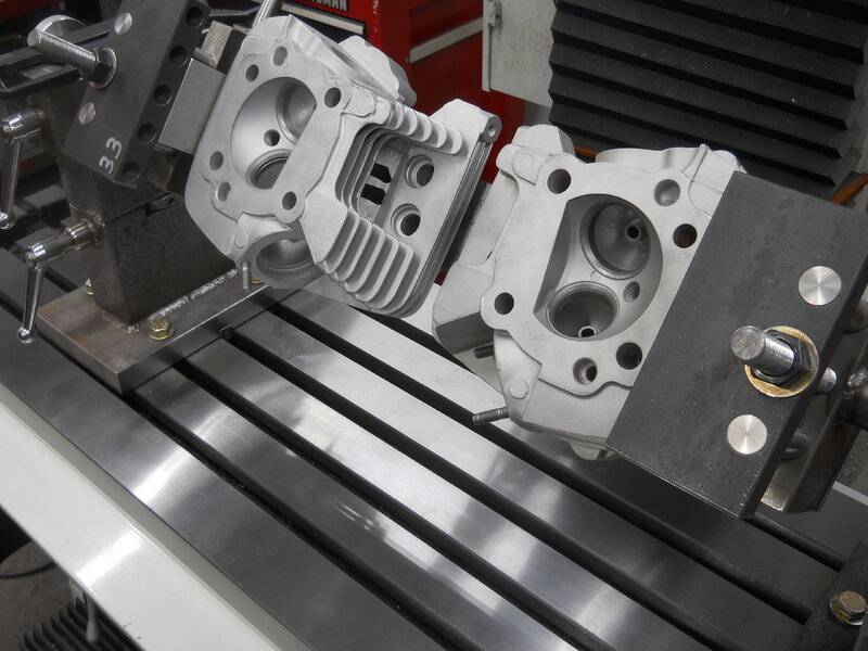

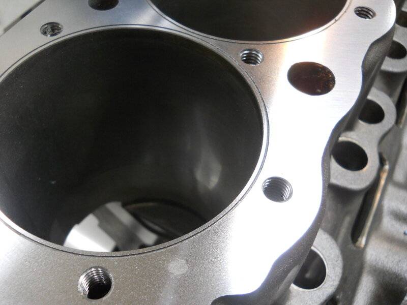

been playing a very long time with several combinations. We build do machine work on all types of race engines. Diesels, Gas, Methanol, Nitro , Procharged, Supercharged, and Turbo. We see several builds by customers and the carnage after installed. The one that blew the gaskets between every bolt was a Small block first picture.
