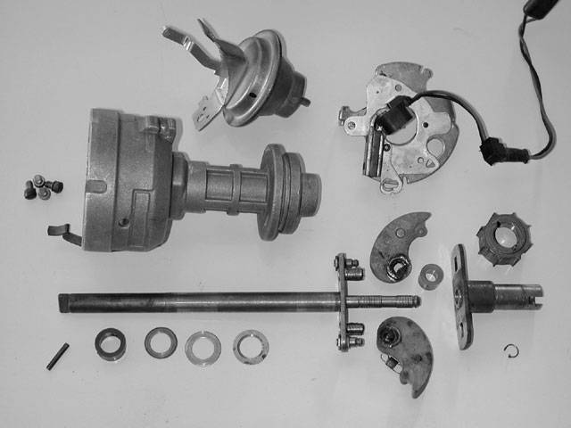

Im having problems getting a consistent 8 thou gap with my 360 LA distributor. I've tried a new pickup and reluctor but the base plate is not very secure and the gap keep changing to the point where it's either touching the reluctor or too large and no spark. Seems there is a little shaft wobble that is not helping. So any tips on improving the existing mopar dizzy or suggestions on fitting a replacement appreciated.

Sounds like a bent upper shaft to me. I have tons what are you looking for exact fit or a curve? Do you have the full tag number on both I can look up the curves for you.
When I stripped the dizzy for inspection it was noticeable the top part that locates on the dizzy shaft and mechanical weight was quite a slack fit. I did wonder if this can be sleeved?
Not sure what you mean be exact fit or curve, assume its to do with advance curve?
Is it normal that when you pull off the rotor arm you pull the top part of the shaft up and out of the mechanical advance weight and then need to mess around relocating it. Or is the a rookie mistake and once learned you hold the reluctor down whilst pulling the rotor arm?
There should be a clip that holds the advance cam onto the main shaft, It is under the rotor. Curve is what the ignition is set to run the engine the best. That one in the pic is probably a whole different curve since the numbers are so far apart. It might run ok or be a dog. Kind of a crapshoot without looking it up. Let me find a picture of the clip. Sleaving that I doubt it. It is machined to tolerance. I have never done it just not worth it to me since I have access to the parts. Bet there are not to many over there to choose from.
Ok thanks, now I do have that clip on my dizzy and I did remove it when stripping it. I must not have put it back on properly or else the top part wouldn't lift when removing the rotor arm. I wonder if that making the wobble worse!!!!

You mean on the weights? No they ae 180 out. Since you have it apart take the main shaft and put it the housing and see if the upper shaft has any wobble, the small part. Also see if the shaft has any side play in the housing. .002 is my limit.

So stripped and rebuilt the dizzy. Dizzy number is 3690430.
Shaft all ok and running true. Think I found the problem the pin and the hole on the new pickup I fitted has the vac advance hole too large and the pin is too small, causing it to float around on the base plate. see image below. So I've put the old ones that is on the RHS back in. It's rebuilt now and got an even 8 to 10 thou variation all the way round. I've made a short video of it stripped and bench tested so I'll post this up later. Just shows how poor a quality some of the parts we buy are. It was a Standard part from Rock Autos, made in china!
