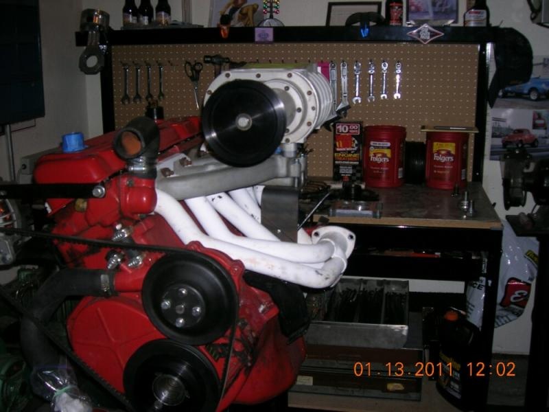

well i havent been able to work on my car much, but i did go back to work this week. so hopefully the money will start rollin in soon. my buddy sent me a few pics today though. he is doing most of the work. he paid for the pulleys for me as a birthday present, and he made a support bracket to hold the weight of the intake and blower. he loves the idea of putting the blower on it, and it keeps him busy. hes 65 and retired. the next thing we need to do is get the angle of the blower right.

Hmmmm.... Just a rough guess here on this. But when you adjust the angle. try this, it may work. just a guess though. Try making a rough duplicate of the flange on the blower but flip it so it is inclined like this / instead of this \
it may level it out perfectly, who knows. but its worth a shot. Wood is always useful for something

i put an angle finder on it one day and found that it was off by 2 1/2 degrees. that peice under the blower is just a carb wedge plate, but its 5 degrees, waay to much.

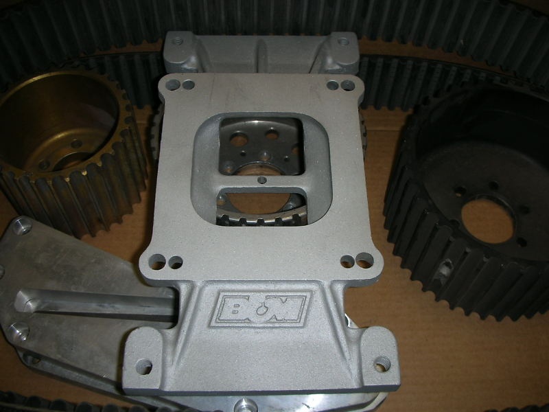

I am confused. It looks as if the blower will bolt to the standard square bore holley carburetor flange. Am I seeing things? I understand about the angle and all, but the blower output flange looks like a standard holley flange. i have built a few engines with B&M blowers and they did not have that flange. It was larger. Have they since changed the blower to bolt to a standard flange holley pattern? for the correct angle, simply remove the valve cover, find the angle of the valve cover rail. Take the angle of the carb flange and subtract the difference. There is the amount you need to machine off to make it match. Done deal. If you really want it dead nuts perfect, remove the head and use the block deck as your reference instead of the valve cover rail, but the valve cover rail will certainly suffice. the block deck is perpendicular to the crank as is the valve cover rail. The crank is your point of reference.
what! how did you find that. thats what i need. the only problem with that would be where it places the blower front to back, as far as the pulleys lining up.
That's a neat piece! I never even knew such a thing existed for a /6. VERY COOL!
check out what i just won on ebay. thanks to hellion_locdogg for bringing it to my attention. this should help me get the blower mounted up.
