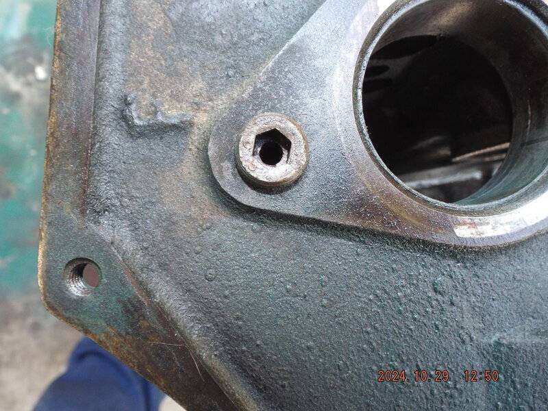

So how cheap & nasty is cheap & nasty gonna be? Before I answer that, here's my first mod. See that hole in the middle of the main oil passage plug? It's a little big, ain't it? That's cause it's a beeotch to drill a .040" hole without the bit breaking. So, my solution is to tap it to 1/4 x 32 UNF and screw a Holley .040" main jet into it. Problem solved and the timing chain now has pressurized oil.

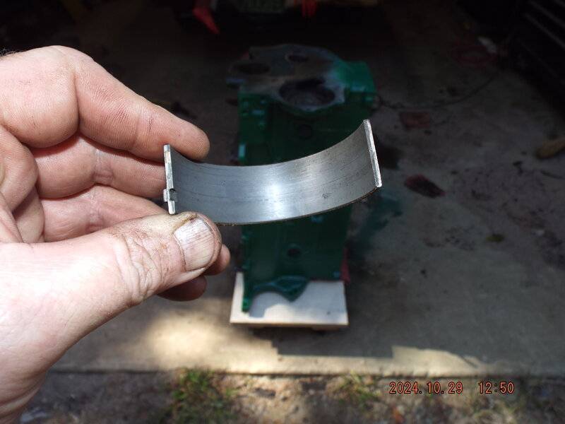

Here's one of the original 1966 date coded main bearings.
Purdy, ain't it? They all are just that good. So are all of the rod bearings. So yeah, you guessed it. They're goin back in.

Will that drilled oil passage plug change the oil pressure values in any way?
It certainly would if I left it the size it is now. When I add the Holley jet, it won't make an appreciable difference. I run the big block high pressure spring in the stock oil pump anyway, so any pressure loss will be retained. There will be nothing for a loss though, with only a .040" hole.
