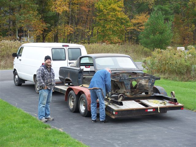

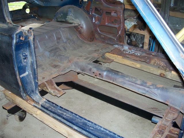

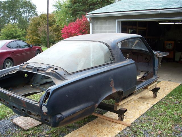

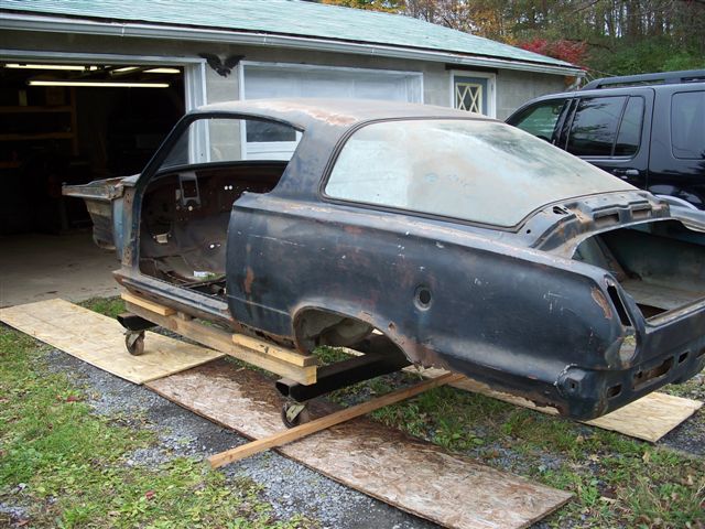

OK - here's what I'm starting with. It's a shell that's essentially been sitting for the past, oh, 20 years.
Looks like you have your work cut out for you, better get busy..LOL
She's gonna need a little work!! I'd definately start with fitting the doors since it has been sitting for so long without a floor like that.
