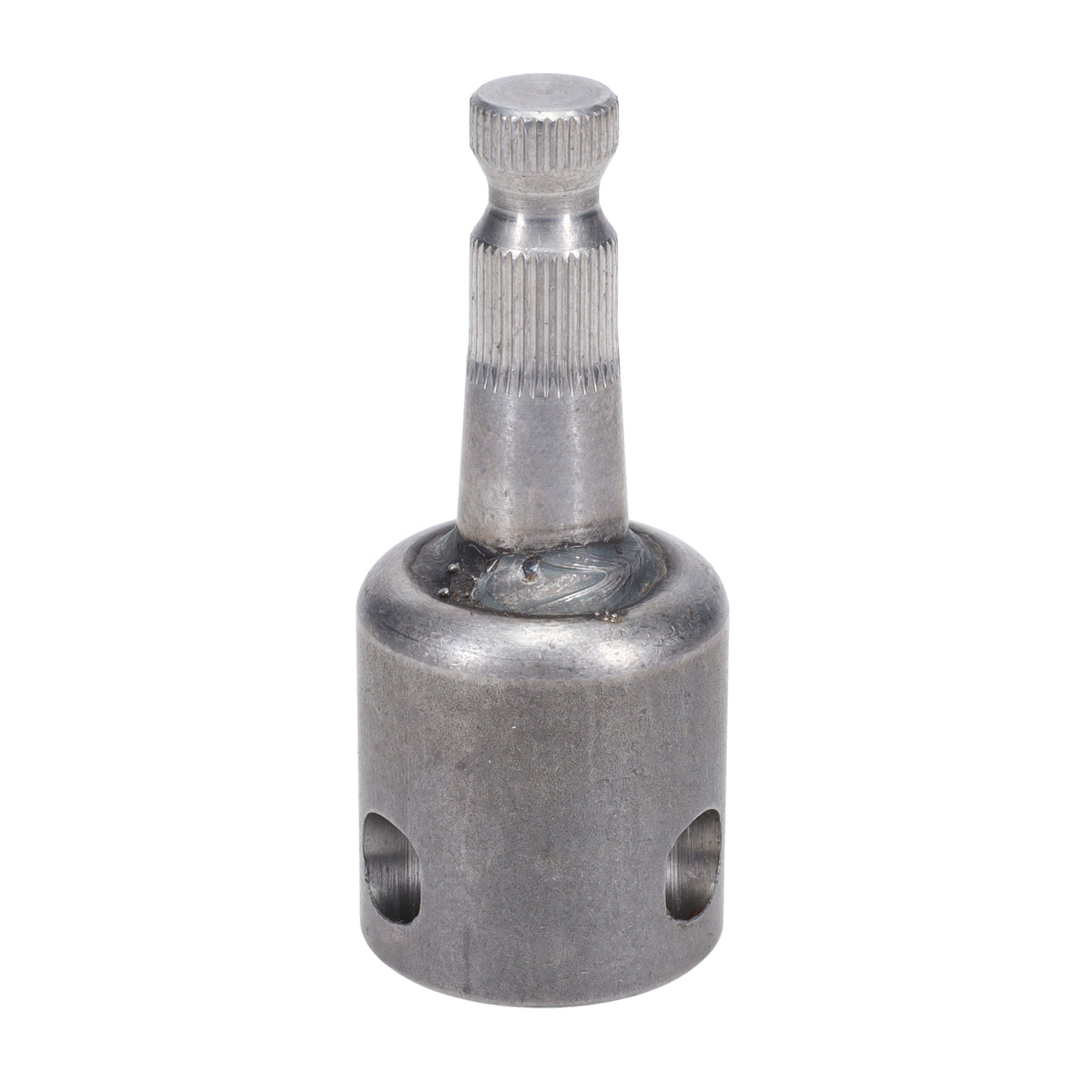

I don't know about the torsion bars, although there's no reason they won't fit. But the gear box issue wasn't PST's fault. You replaced a power steering box with a manual. The manual box is shorter. You didn't need a longer steering shaft. All you needed was this:
agreed. that or weld 2 couplers together to make up the length.

Well obviously my initial measurements and comparisons were AFU. My apologies to PST. I will be ordering new torsion bars tomorrow. It still bothers me that when I select check fitment it says "Does not fit Valiant 200"
