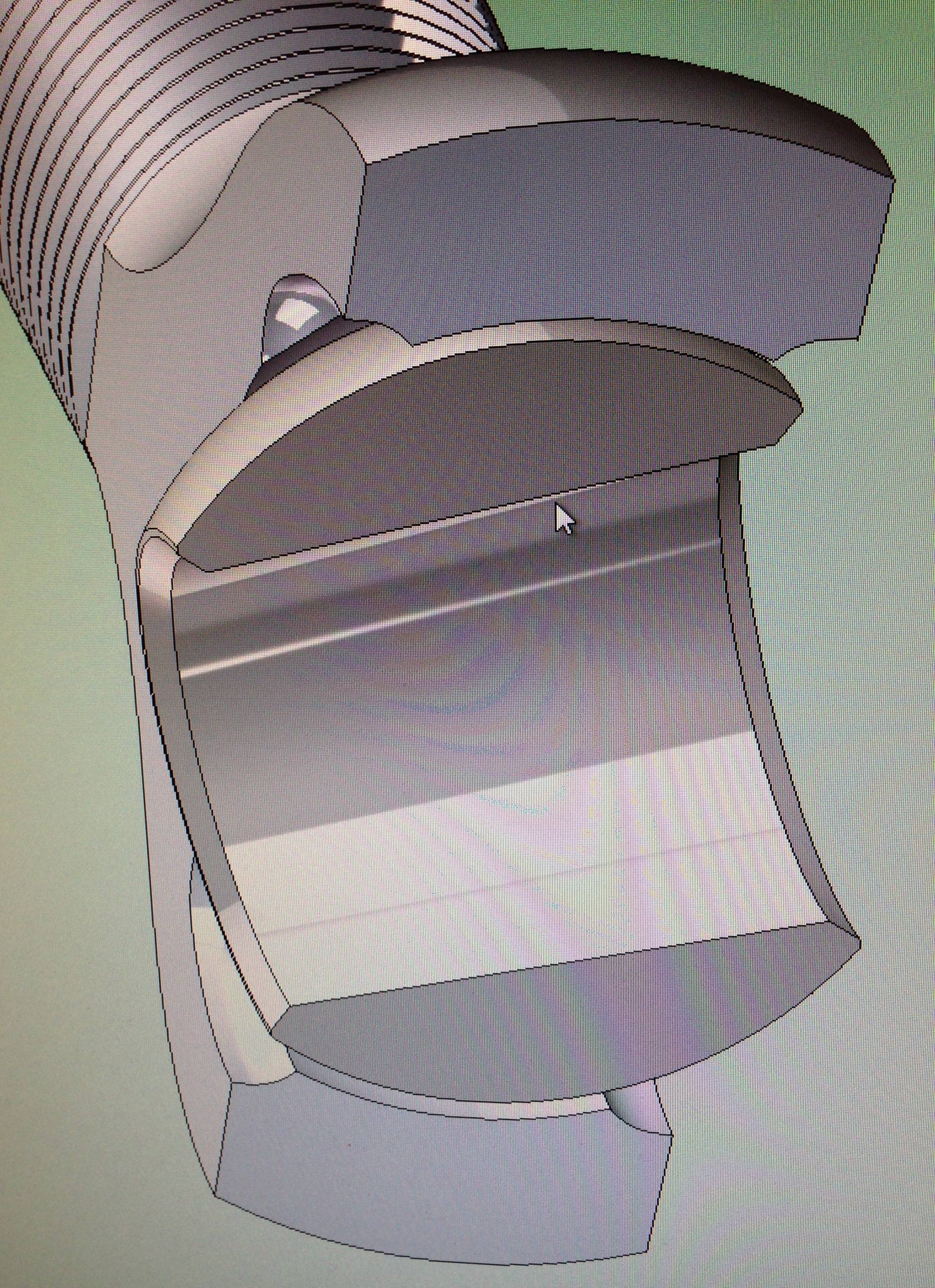

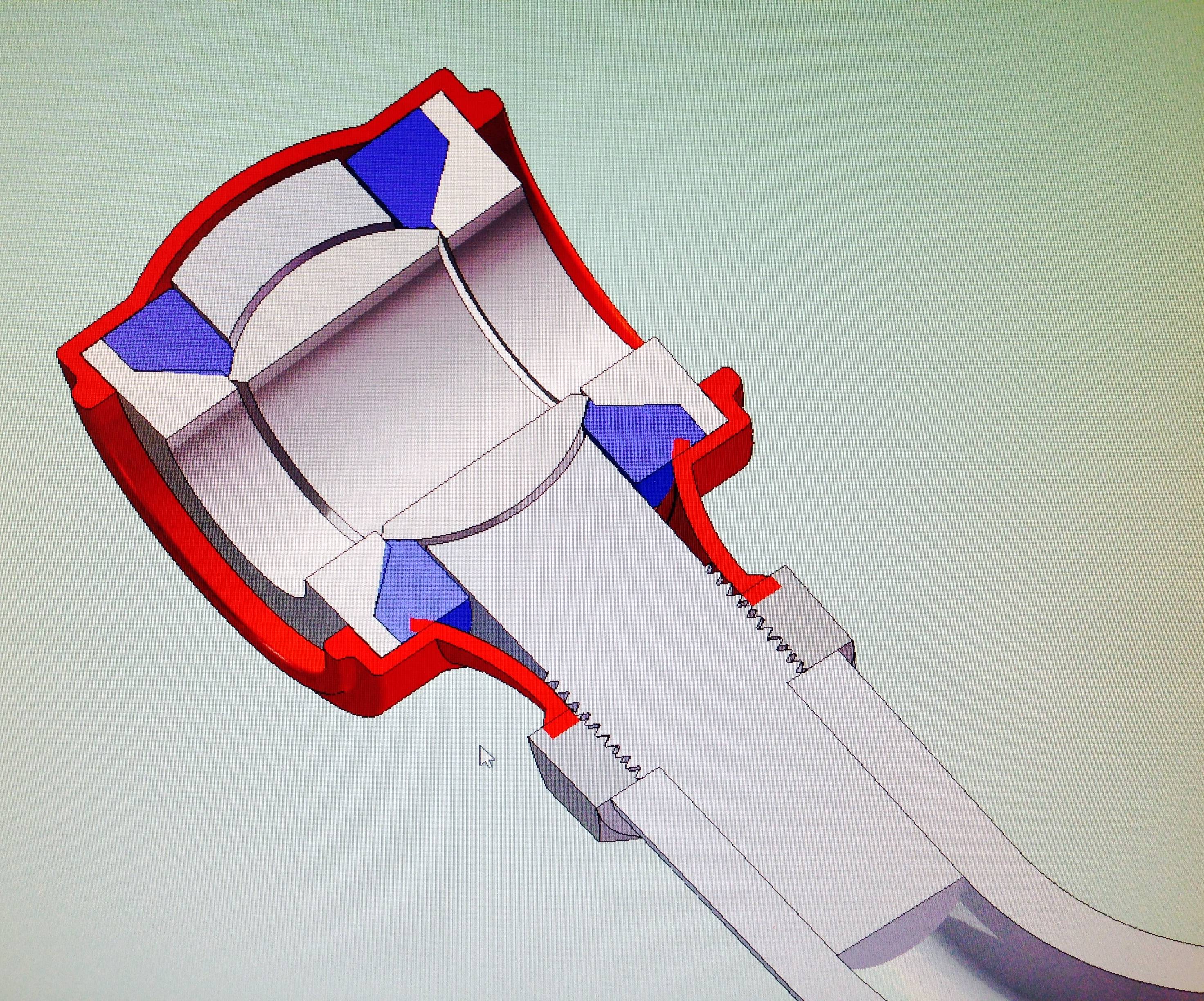

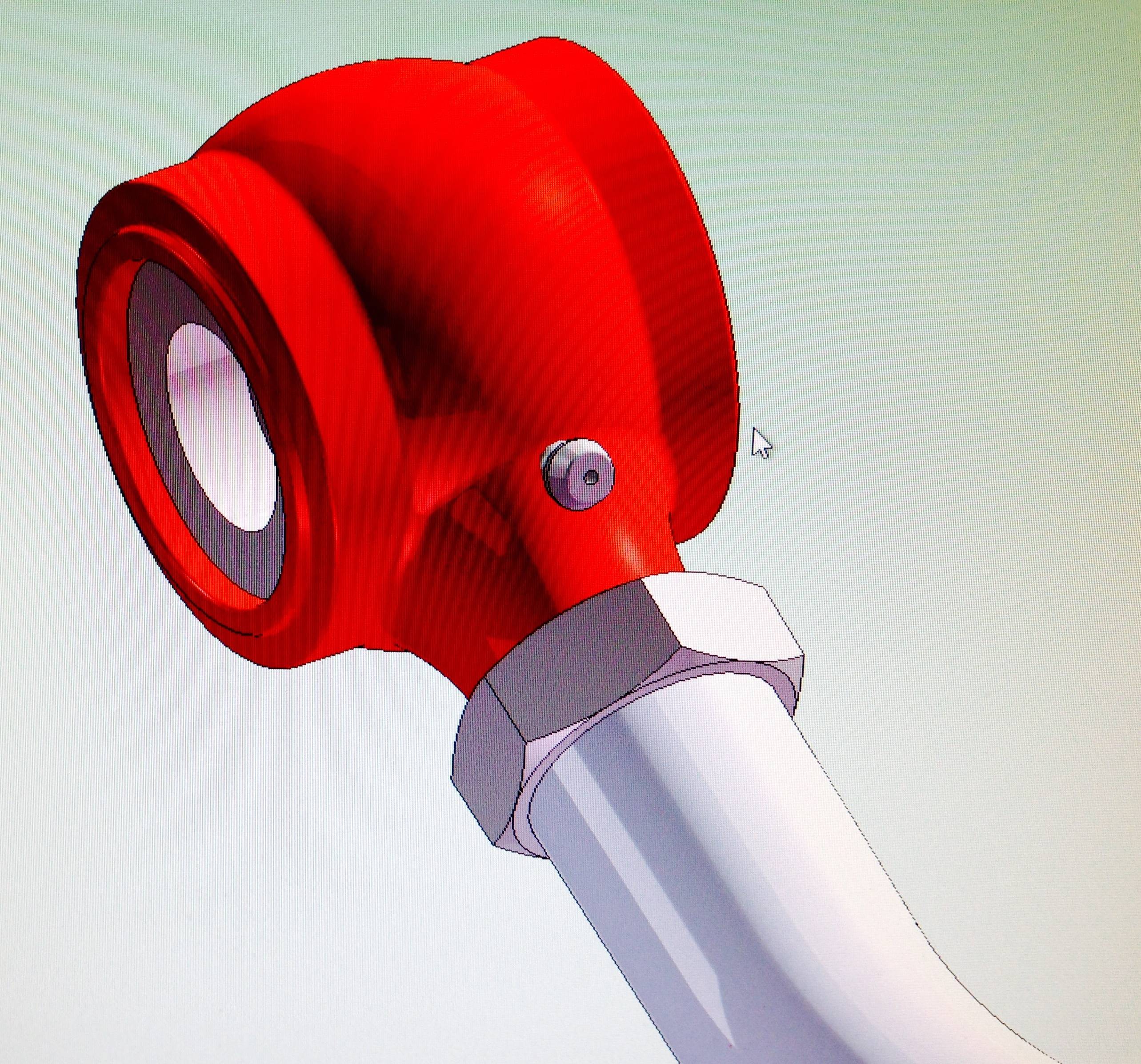

This is the difference between when a Aerospace Engineer tells you there is no room on a Heim joint to fit grease zerk 100's of time on social media, and a Mechanical Engineer who actually works with this stuff. The oil impregnated bronze liners would blow their mind.
Who sells those?
Just about everyone. Google them. They've been used in industrial machinery applications since I've been in engineering the past 30 years. I even see them at farm implement dealers like John Deere, International, White...
gotcha. those are usually pretty heavy, so it's a trade off im assuming?
No, they make greasable ones in all sizes. And a lot of parts and boots no body knows exist.

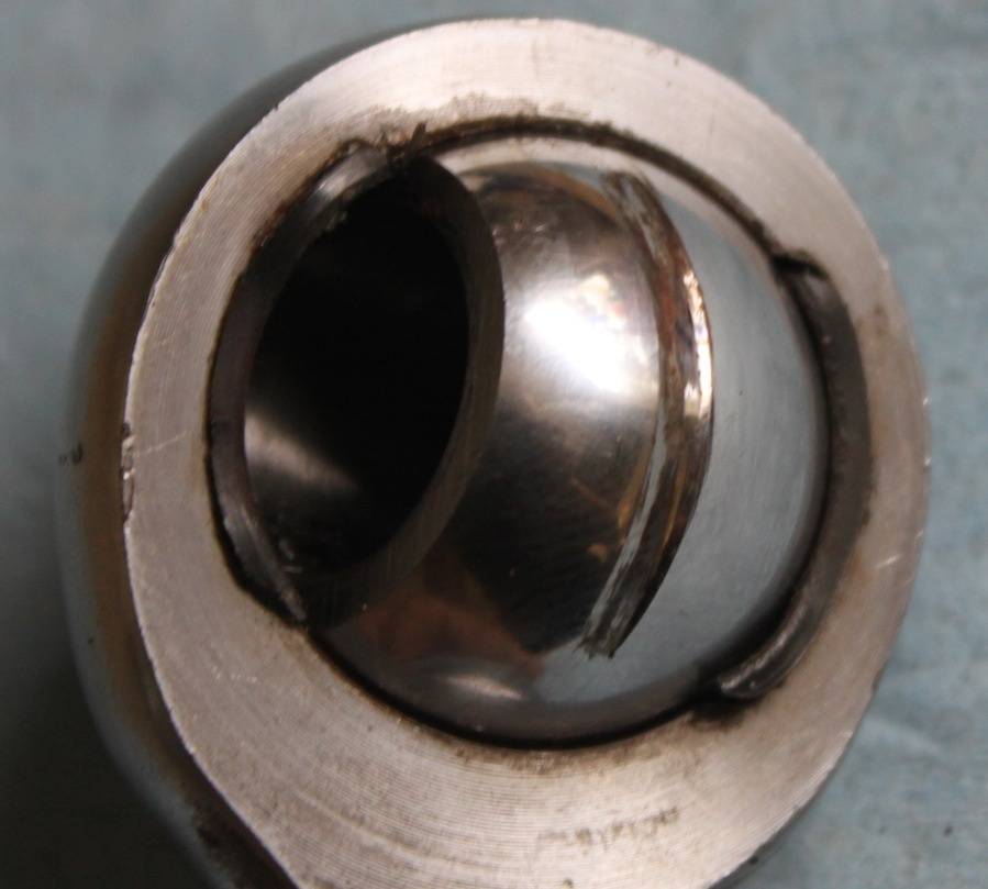

And if you severely swivel a Heim to one side, you run the risk of it being free on one side, and binding on the other. It will dig a groove in the ball usually on one edge and the edge on the other opposite side when the force vector tries to force the ball on a outside corner.
