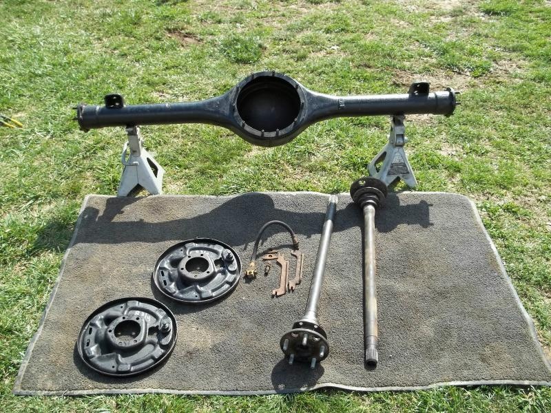

Here's a picture of what I won-the axles don't look like they've been redrilled (just figured the bigger holes are for access to axle retainer bolts), but I'll check them when they come in of course-thanks for the reply. I planned to keep it all SBP for the time being, anyway. Swapping over to BBP will require a little more money to do than I want right now. I already have a pretty good amount earmarked on one of Mark's Dashes, and that'll require a couple hundred more on gauges and such to get installed. I also have to get my exhaust worked this week, then drop in my "new" engine, then front glass....

Ok, so from what I gather, I cannot use the backing plates from my SBP 7.25" on the 8.75" assembly, right? If that's the case, are the brake parts compatible, or do I need to source new hardware, cylinders, shoes, and drums? What about the driveshaft-is it the same length? Is there anything else you can think of I'd need apart from a center section? My brother said he'd give me his old pig for the cost of shipping-741 with highway gears. I know it's not the big pinion 742 or 489, but it'll only be behind a stock 5.2 Magnum converted to 4bbl with a dual plane intake and 904.

Yes, the 7 1/4 SBP backing plates won't work on an SBP 8 3/4. The BBP 7 1/4 ones will fit if you have the BBP axles for the 8 3/4. The SBP 7 1/4 brakes will swap over to the SBP 8 3/4 if you get the correct backing plates. Driveshafts have to be shortened going from a 7 1/4 to 8 3/4. You'll need the correct, bigger U-bolts and shock plates too.

Got it...I think :scratch: Thanks! The axle is pictured above, and it shows backing plates-I would hope they are the correct ones for the axle. The seller said it was from a '68 Cuda; if those are the wrong ones and I have to go digging, will any SBP 8.75" backing plate be correct, or is there a different vehicle app that would work?

The backing plates are matched to a brake size and axle housing....not bolt pattern. The only ones that will fit have to come off an 8 3/4 rear with 10 X 1 3/4" brakes. That limits the donors to: A-bodies, and B-bodies with 6 cyl. engines and 10 X 1 3/4 brakes. Not a big pool to choose from. Your best bet is to find someone who has converted to the big bolt pattern and has the old backing plates still kicking around the shop.
