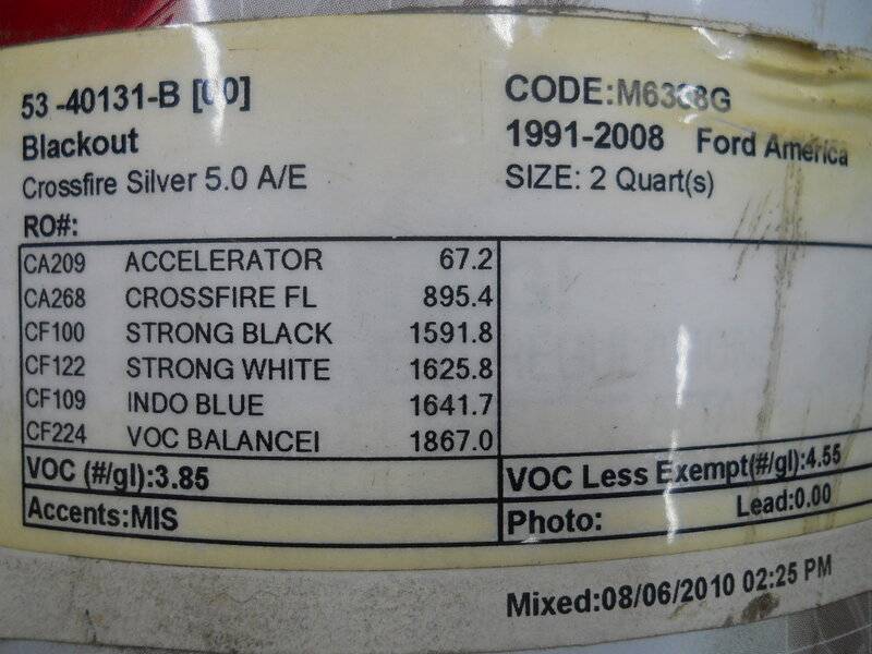

use this it never stains . And if you get wax on it you don't see it. Wipe water beads and stains right off. I won't use anything else. easy to match and easy to spray.

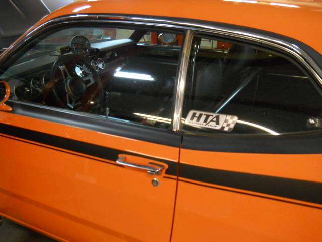

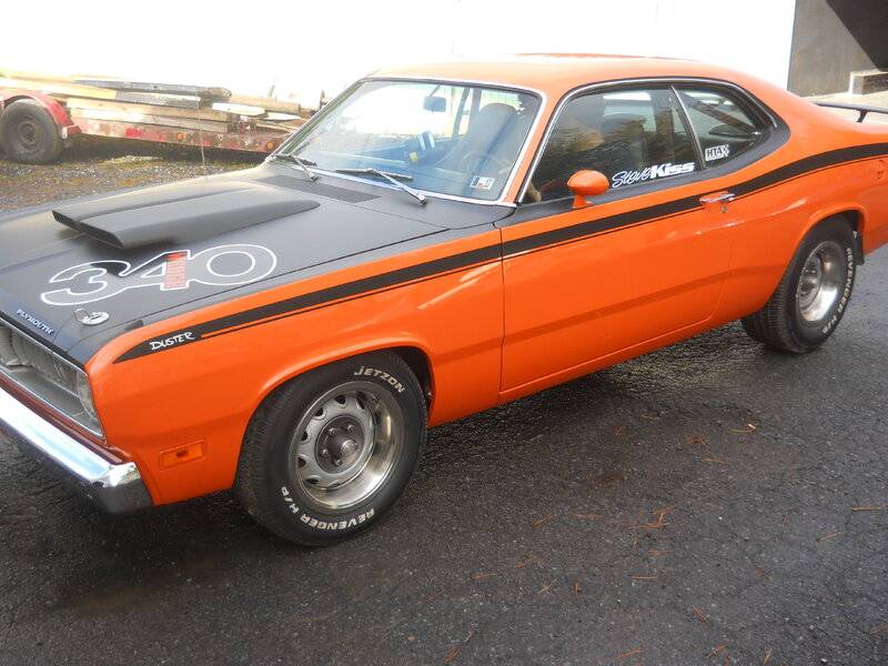

It matches the black stripes perfect. The paint is black. I won a show a while back for best body and paint. Here are some more pictures. on some pics the glare makes it look gray but it is black. When used with the black ladder stripe on the hood you cannot tell the difference next to the tape stripe. Also used on dash boards and interior doors on a V24 option car

May I ask where you ordered the paint from please, is the paint made by Cross Fire

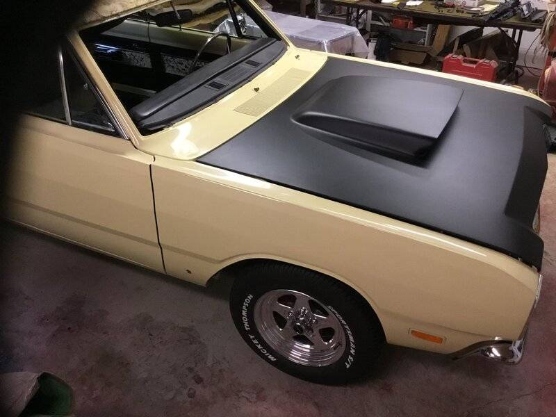

Now in satin black, before in flat black - difficult colour, never looked evenly...
Satin black correspondends good with the black of the stripe kit, which is also a satin-like black.
