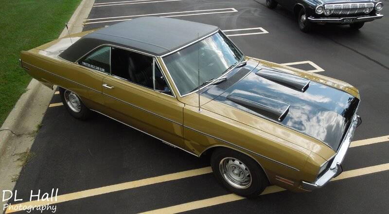

I bought the paint at our local NAPA they carry paint and body shop supplies. (Martin Senior) I gave the paint code above. Just used it on this car also. As stated water drops and wax do not stick. Wipe it off just like its gloss and it matched stripes perfect. Spraying it is idiot proof with any cheap gun. I used a Harbor freight throw away $16 gravity gun. Even The base coat is idiot proof. The clear is where you need the good gun to prevent buffing.

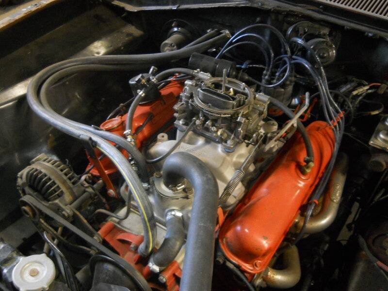

Same car when we brought it home. We installed the driver motor then pulled it for paint after we stood back and saw how bad it looked. The motor it came with was a solid lifter 408. its in the mill today getting square decked and redone for the new owner. Its going in a Barracuda
