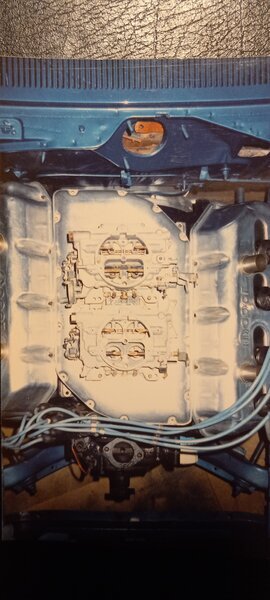

Hemi carb before
The pair after.

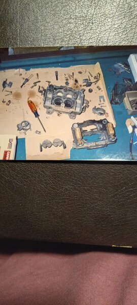

Not even sure what i'm looking at there? looks nasty though
Is that fire extinguisher powder?
Top pic, one of the Hemi AFBs as received, bottom after the rebuilds. Powdery junk is typical dried-up fuel residue, although there was backfire evidence, lol..maybe a little??
