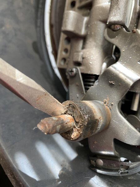

Wait for someone to confirm but I believe if you do it from outside you have to hold the shaft up while changing. If you don't you will have to drop the valve body. I did it on a 727 a while back but can't remember ****.
You can do it from the outside, but usually headers and exhaust are in the way, and the floor. If you drop the valve body, usually the converter will drain, so you will need more fluid to refill. Usually getting the old one out is not the problem, putting the new one in with the limited space is. But I have done it with out removing the valve body
you can get the seal out from the top with a small screwdriver or pick, but it's kind of a fiddly process and there's not a bunch of room for activities in there. but it's doable.
i find it easier to drop the pan, drop the valve body and pop the seal from underneath. throw a fresh filter and gasket on the pan while you're in there.

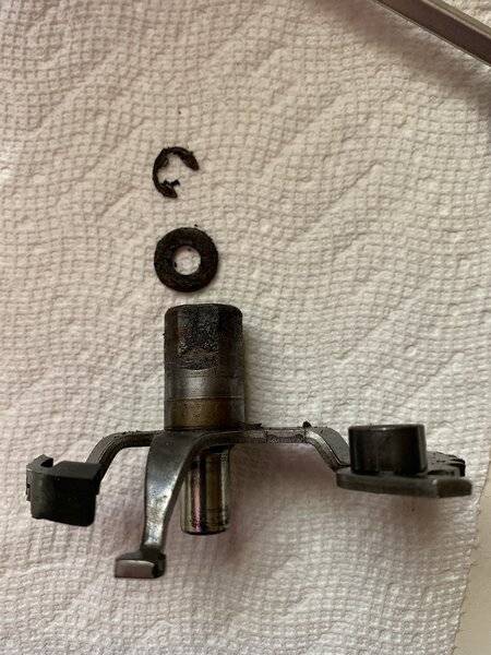

remember, there is *two* seals in there: one for the gear selector (gear lever) and the other for the throttle shaft (kickdown).
sometimes a groove gets worn into the shaft and you'll need the wider/taller seal which is #22072A
I drop the valve body. To install I use a nut and bolt with a large washer above the seal to press them in and it stops right at the case.

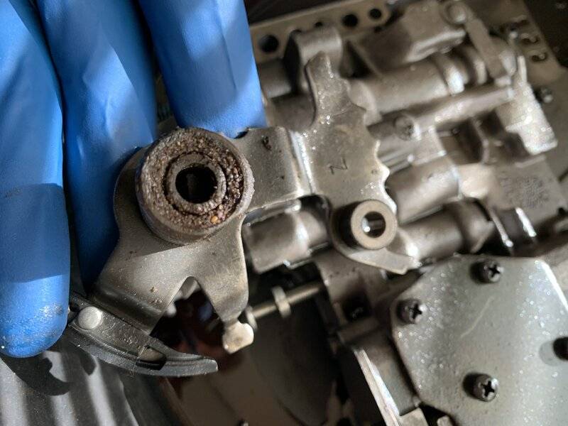

Remove the valve body.
It is not very difficult in a Mopar 904 or 727 and no check balls fall out. It is fairly difficult to get the old seal out while the transmission is in the car and valve body is still in place. Not much room to work above it. You already have to remove the throttle/kickdown lever and the shift lever and once those are off it only takes a few minutes to remove the valve body. Plus, if the valve body is out you can clean off the area where the seal rides.
Here is a video Cope did a while back for another member here. This is how easy it is once the valve body is out.
