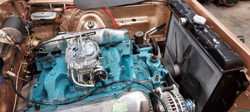

I modified a junkyard $5 shroud from a dodge truck for my 69 barracuda. They have the same offset as the a bodies. Took a little bit of trimming and improvised mounting, but looks and works fine. Not perfect, but mine is a driver, so I am not aiming for perfection.

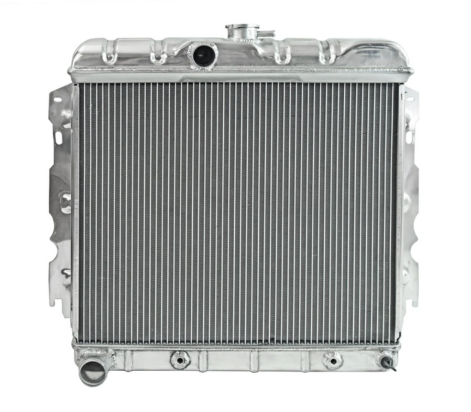

Griffin Performance Fit Radiators 8-70038-LS

The summit pic looks like my 28x19 crossflow. I think a guy could get a little wider in a 68 fish if he wanted to. If I ever have to buy another for this car, I`ll try a 29 or 30 , ----------probly would have to trim the frame rails pinch welds for a 30 tho.
