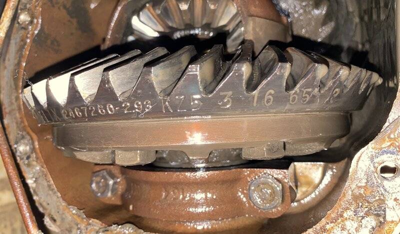

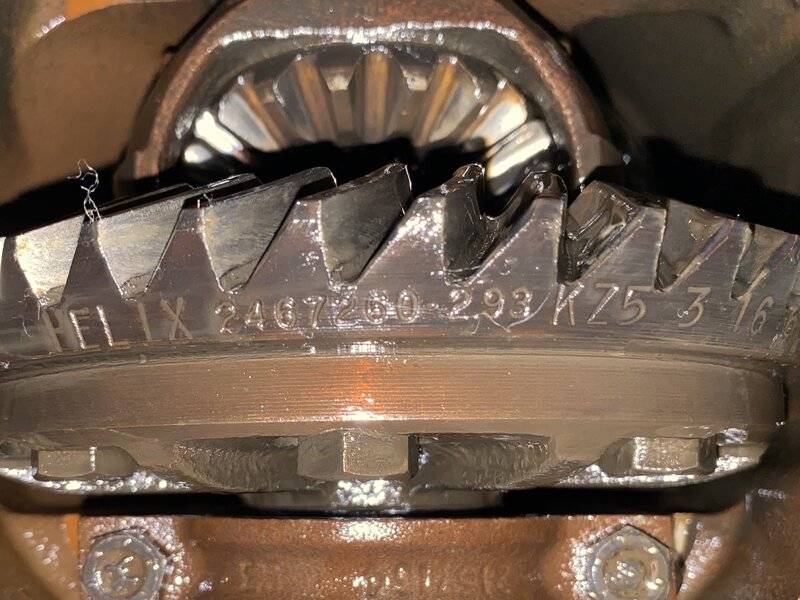

Hey FABO, well I got some of the diff cleaned off and found some numbers. Looks to be 2.93 am I reading that correctly for the gear ratio? Just wanted to be sure in what I’ve got for a 7-1/4 rear end and what else these number might be able to tell me??? HELIX? Any feedback greatly appreciated! Thanks everyone! (How does it look in there?)
Part number - 2467260
Ratio - 2.93:1
Unknown - KZ5
production date - 3-16-65

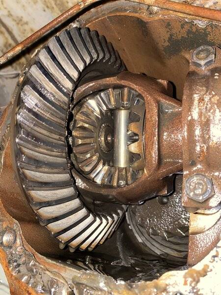

The faces look well worn.
Does the bar the spider gears are on move when you rock the yoke back and forth?
The bar does not move but the spider gears do fall down, slide just very very very slightly when rotated if that makes sense… well worn as in trash? Or well worn as in American metal run it?
