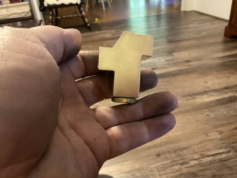

Looking for a factory original or correct rear brake proportion valve it’s the one that goes in the rear brake line and is attached to the inside of the left frame right under the floor pan.
Here’s a pic for reference please let me know if you have one available
Thanks
69’ bee with single piston calipers and rear drums
A '69 Super Bee would have Bendix 4 piston calipers from the factory.
the car had drums originally and are what would have been standard.I removed the drums and am converting it to discs
Most disc brake conversion kits I've seen have a matching proportioning valve included. I'd use the one they recommend, or an adjustable one.
73’ up spindles 80’ volare calipers and hoses 11.75 rotors and manual 15/16 bore master. While I appreciate the feedback I’m good on the parts I’m using just need a factory proportion valve to complete the swap. I’m fully aware of adjustable valves and later blocks with proportioning and metering all in one unit.
