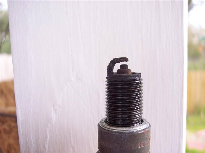

Pull your spark plugs one at a time, and inspect them. It sounds like it's burning it. The new seals would more than likely seal even with marginal guides, so I'd be more inclined to say its a ring issue. Also, rings tend to smoke more on load, rather than idle and start up. The plug will be black and wet looking compared to the ones burning well.

Six quarts in 1500 miles is most definitely in the excessive catagory. Just based on that alone I would have to go with a ring/cylinder problem. You should definitely see wet plug(s) with this amount of oil consumption.

Here is the number two plug and the threads look like they have a little oil on them.
