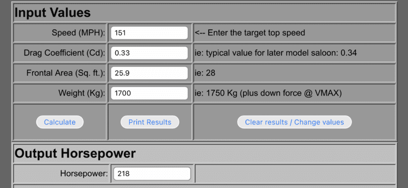

With the 2012 impala numbers @junkyardhero posted I show you need about 218hp to go 151. Isn’t aerodynamics amazing? There are some assumptions here and I don’t know downforce so……..
The formula data sheet I made says roughly 385.6hp for a 68 Dart to do 165 based on frontal area, drag CoD, etc. And 434hp for elevation at Bonneville.
