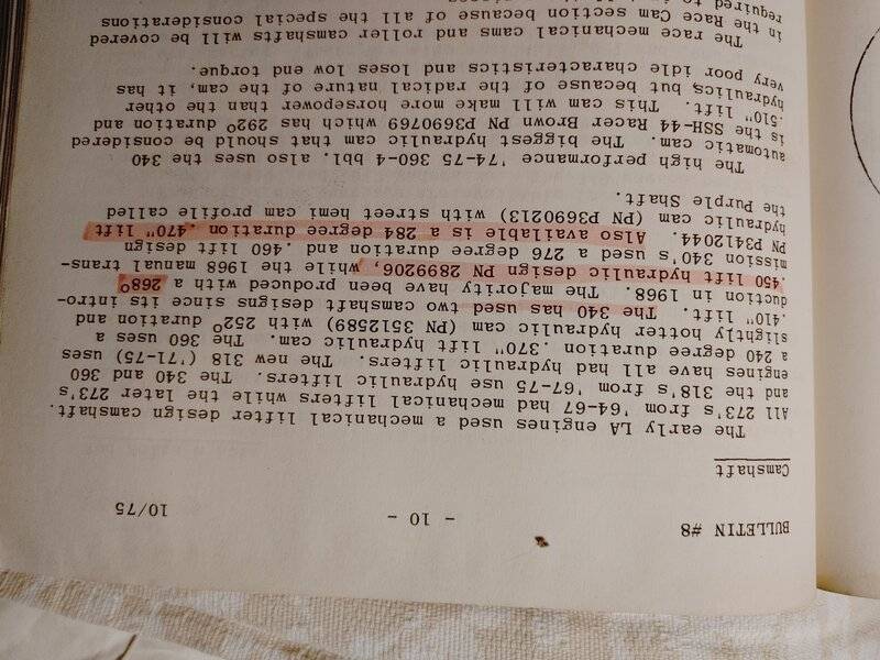

Apiril 1976 DIRECT CONNECTION RACING MANUAL
Here, let me fix it for everyone so we can read it
That is 100% incorrect. All of the 340 cams were split duration cams. Had more than one 340 cam degreed and cam doctored and NONE of them were ever those lift specs.
My 2 cents it was written that way to sell more purple cams.
The 340 4 speed cam was the 340 auto exh lobe moved to intake side and a 440 mag int lobe set used for exhaust.
What A56 posted earlier in the thread is SPOT ON!!!!

There is PLENTY of incorrect info in the "Mopar" manuals over the years. Just because someone wrote it doesn't make it correct.
@Brooks James
The service manual for one.
I guess my own experience with these engines and building them over 45 years, nah I didn't write a book. Just know with my own eyes, tools and measuring devices what is right in this case.
Hearsay wont work. Lets see something in writing.
@Brooks James
Hearsay is inadmissable, as well as polygraph results , in court. Lets see some hard evidence.
I don't think he will share.
He's already got one MOPAR source for the correct specs that he can look up himself.
That performance manual is DEAD WRONG. But because someone wrote it it must be fact. Plenty of documents throughout history have misinformation in them that the masses take as facts.
A56 posted the correct and an incorrect set of values in this thread BOTH from MOPAR sources... at least the Race manual has the correct part number, but, they changed the grind from the originals.
