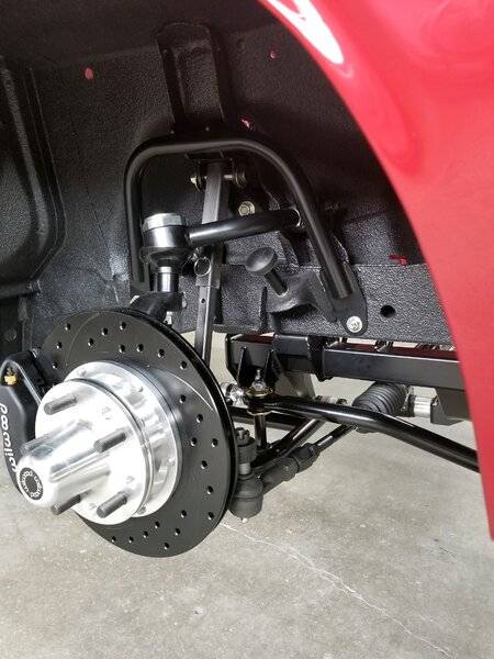

Please note how much higher in the chassis the upper shock mount is than the other brands. Also note how much shorter the control arms are.....the set-up allow the hub to be further tucked in....about an 1"
posts 9 an 10 are replying to the mopowers post 8. OEM K and steering with HDK components for the coil over only conversion.
HDK Single Lower arm Torsion Bar Eliminator Kit
post 11 and 12 are a reply to mopowers post 4. Pics are of a 67-76 HDK rack and pinion / coil over conversion installed in a 68 Dart
