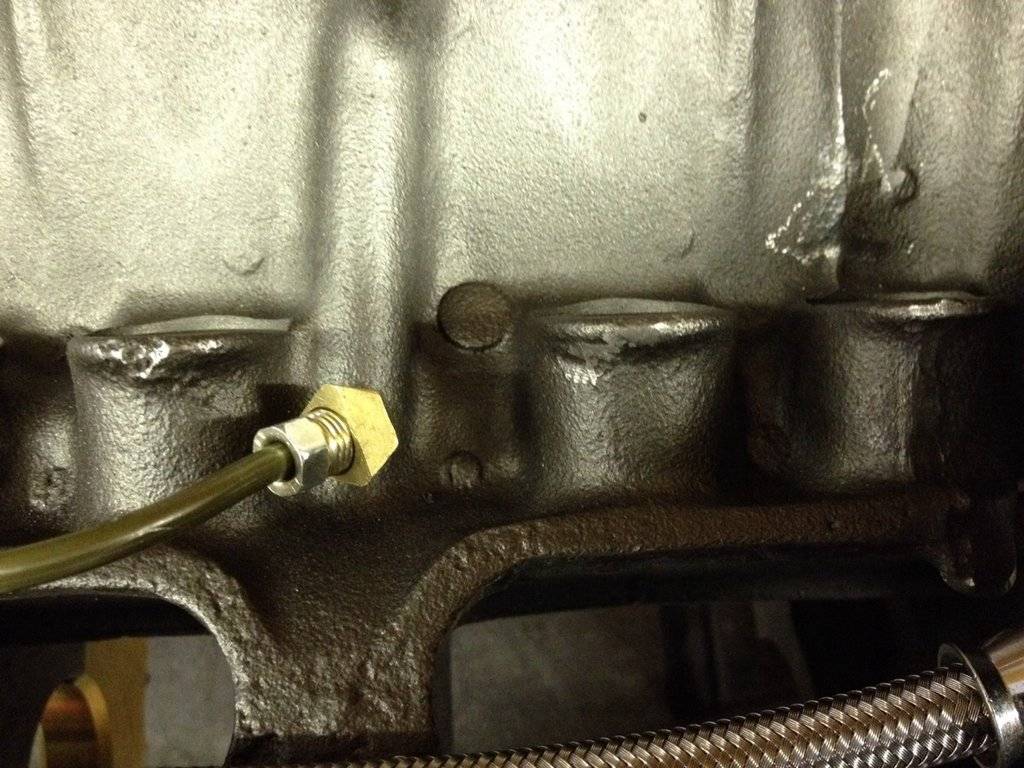

ok the here is what I have done I have drilled right into the left side oil passage thought the oil feed to the head with a .250 drill and cut off oil supply from cam by drilling 1/8" in between two holes of the cam bearing and install so it lines up with mains all done so mains and rod don't starve and went with a an-4 cross over to right side I all so done all the other oil passage mods including the an-6 lifter galley mod with the #1 left main block off and it now is feed by the right side I know from building small block chevy race engines with shaft rocker that full roller rocker use more oil but they oil though the push rod I just want to know what size is too big and I'm not going to debate my decision that being said WHAT IS TOO BIG!!!!!!!!!!!!!!!!!!!!!!!!!!!!!!!!!!!!

Ok, here is what I have done. I drilled into the left side oil passage, through the oil feed to the head, with a .250 drill and cut off oil supply from the cam, by drilling 1/8" in between two holes of the cam bearing, and installed so it lines up with the mains. This was done so mains and rods don't starve, and went with a AN-4 cross over to right side. I also did all the other oil passage mods, including the AN-6 lifter galley mod, with the #1 left main blocked off. It now is feed by the right side. I know from building small block Chevy race engines, with shaft rockers, that full roller rockers use more oil, but they oil though the push rod. I just want to know what size is too big, and I'm not going to debate my decision. That being said, WHAT IS TOO BIG!!!!!!!!!!!!!!!!!!!!!!!!!!!!!!!!!!!!

for all of you that want to know what my gain is to convert to full time flow you block off the flow through the cam and that directs that oil to the mains and the 4 rods that see a pressure drop every time the hole in cam line up and at higher rpms that pressure drop is a bad thing and my thing was is to put the restrictor in the deck so I wanted to know a size sense you would have to pull the head to change it but after looking at the problem for little while I found a way around having to put in the deck I was able to put one in the head under rocker shaft so I can just pull rocker to change size plus full roller rocker want more oil to keep the needle bearing alive
OK. So you just pull the rockers and put the restrictor in the hole coming up at an angle to the bolt area? That sure does make it easier.
that is correct it needed a little work with carbide rotor file so a tap will start and then tap it with a 5/16 -24 you don't even have to drill it this way I can start at an .080 hole and correct it from there as of to day I have install all the cam bearing 2,3,4 I have drill the oiling hole to 1/8 and I left #1 alone because I'm running the Milidon timing gear drive and I want the extra oil for the oiling of it

I went with an . 080 restrictor and I have ood oil flow to rockers and no oil pressure drop

I am doing this mod on my new build very similar to how you have done it. This mod is now in the stroker small block book by Jim Sziligy. You are doing it slightly different because of the rockers you are using. I am using a bushed rocker(Norris) and the recommended
Size hole in the oil galley is .050 thou with no restrictors in the deck or head. Because you drilled such a large passage in the galley you will have to restrict elsewhere or you will have very low oil pressure.
You should post a picture of what you are doing because many people confuse this crossover line mod with the crossover mod for number 4 main bearing which is completely different.
What you are doing by drilling the new relocated holes in the cam bearings is twofold. One is completely cutting off the oil to the rockers from 2&4 and restricting all the cam bearings to 1/8 inch feed from the mains. I did that too exactly the same.This makes the block function as a priority main system if you have also cut or restricted the supply to all the lifters. This should make all the rods and main bearings oil much better.

The brake line in the picture does not plumb into the galley, only the passage up to the rockers, but technically it is called a crossover line.
