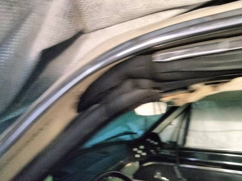

Not a fun task for me. The roof rail weatherstripping was made by Metro. Good quality and great customer support. No adhesive held in the old weatherstripping, pulled right out, so that helped. Installing, the new weatherstripping behind the wing vent window stayed in without glue, but the top and part behind the quarter window needed lots of glue. The problem was with original design. The inside lip on weatherstripping was wide and stayed in metal channel. The outside lip was too narrow to stay in channel so it needed adhesive. Done.
I recently began replacing mine as well Factory install. Only glue used was on the leading edge above wind wing. Weatherstripping was cut into 3 pieces from the factory. I just finished up the drivers side, rolled up the windows & Im going to leave it sit for a few days to get used to the new rubber
