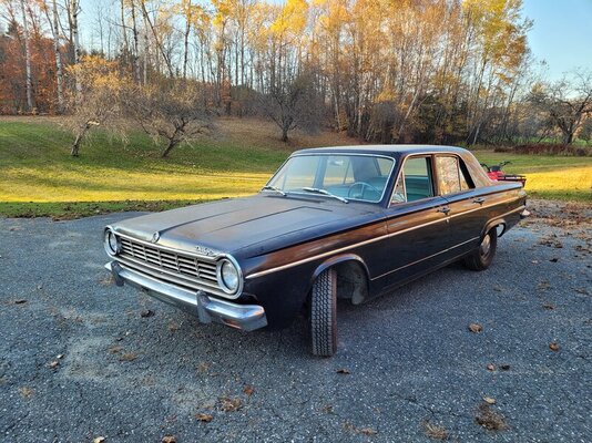

Here’s a teaser of pic of Rosie as I initially saw her:

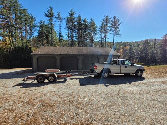

I had a U-Haul car trailer reserved but I’ve also had terrible luck with U-Haul reservations in the past. The morning of purchase, I packed up my beater F150 with Supplies for the rescue: Gas, oil, a fresh battery, tow straps, a come-along etc.
I drove down to U-Haul and miraculously they had a trailer ready for me!!! We hooked up the trailer and even more miraculously the trailer wiring on the truck still worked. I should have bought a stack of lottery tickets at that point.
This, my friends, is what the beginning of a poor financial (read “fun”) decision looks like:

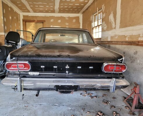

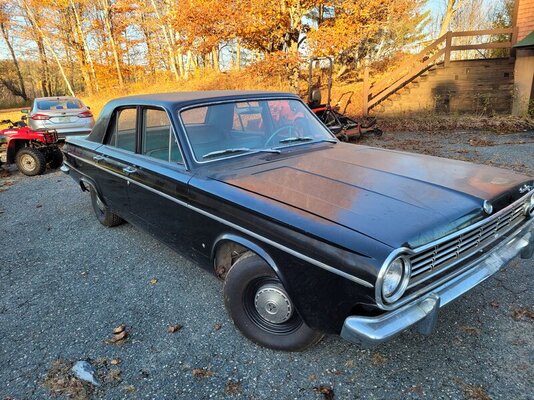

This is my first glimpse of Rosie:
Notice the original dealer sticker from Florida, and what I presume is the original tailpipe. Underneath was a cherry bomb cobbled into the exhaust with bunch of reducers and pipe clamps. I was transported back to my misspent youth in the 1990‘s.
Keith and I pushed the car outside and it looked even better than I had imagined.

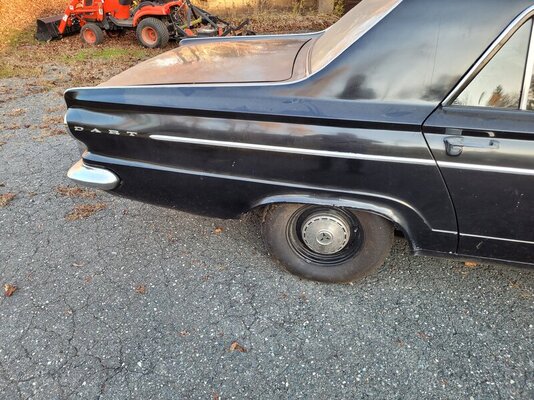

The “rotted” quarter panel. I might be able to sweet talk my way into an inspection sticker with that little amount of rust!

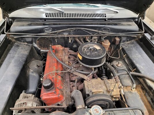

The engine seems unmolested:

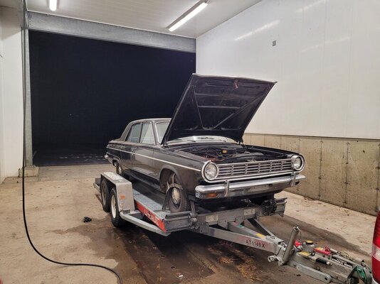

I stopped by the car was on the way home to give Rosie her first bath in 20+ years. This is the before photo, unfortunately, literally 30 seconds after this photo was taken the lights in the wash bay went out and I used my flashlight for the duration of the wash.
When I got home, around 10pm I cracked open the master cylinder and found nothing but a thin layer of rust at the bottom. I cleaned it out best I could and tried “bleeding“ the breaks by myself, in the dark, on the trailer. Turns out this thing had two 1/4” bleeders, one 5/16“ bleeder and one 7mm bleeder screw?!? Amazingly all of the brake lines were intact. I robbed the fuel tank off my snowblower and was able to get her running long enough to back her off the trailer and into a temporary parking spot.

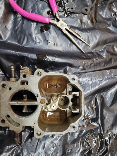

- Started cleaning and soaking the carb. It wasn’t that bad in side and all the jets came out without a fight:

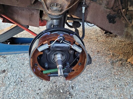

After the parts arrived I went through the front brakes, wire wheeled and painted things as they came off and cleaned up literally inches of grease off of all of the suspension components. This car was owned by a farmer and it showed. Not only did it seem like this car was greased up before ever use but there were some “interesting“ brake line repairs.
Boring photo of the new front brakes and hoses:

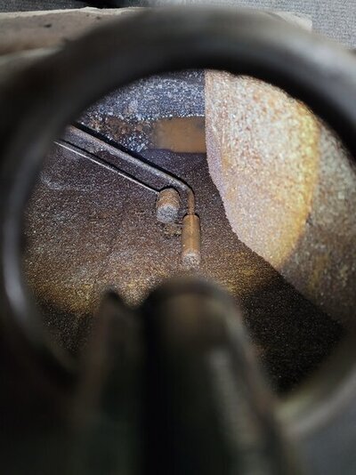

I tried blowing out the gas line but it was completely blocked. I shoved a long piece welding wire through the fuel line but couldn’t find the blockage so the problem was likely with a clocked fuel pickup and it turns out the tank was completely junk:

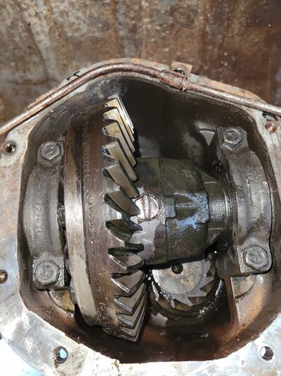

While the fuel tank was out, I changed the diff lube. Looks like the Pinion seal on the diff and the output seal on the transmission have been leaking for a long time. Luckily, there was still at least a pint of some goo That identified as gear lube. Looks like I’ve got 3.23 gears:
There is a lot of slop in spider gears but as much as I hate doing a job twice that will have to wait until a later date.

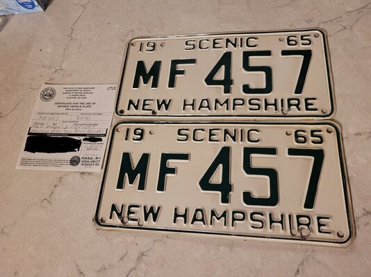

New Hampshire has a cool law that allows for the use of vintage NH “Year of Manufacture” plates. I wanted to find a decent set of 1965 NH plates that started with “M” signifying that they were originally issued by Merrimack county, where I live.
I searched a local flea market and a couple antique shops. I looked on EBay and even tried contacting a couple antique plate sellers but kept coming up short. I figured this scavenger hunt was going to take a year or more but thanks to insomnia and the internet, I found a set of plates in a country store in West Virginia for $26 which was way less than what they were going for on EBay. The only issue with the plates is that someone drilled two extra holes in one of the plates, but in my mind that’s just a little wear-and-tear that adds to the authenticity.
It took a couple trips to my local town hall and the Concord, NH DMV but Rosie now has plates. Even better, the registration only cost me $25 for 2 years!
Yes, I am aware my plates say “MF”. :)

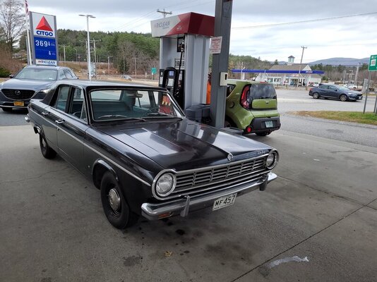

We took a trip to the gas station, the car wash (once in the manual bay and once through the automatic stall to get the underside washed) and finally picked up a pizza And headed home.

Fix the rusted out, right rear wheel arch (no jagged metal allowed)
I was hoping Larry would let me slide on the rust repair. I asked him if I could just trim and sand away the jagged metal because I didn’t want the paint on the rear quarter to look different from the rest of the car until I could get the money together for a full and proper respray.
Larry assured me that if I could get some decent patch panels we can fix the rear quarter and blend the paint at the a body line and make it so no one would notice the repair.
