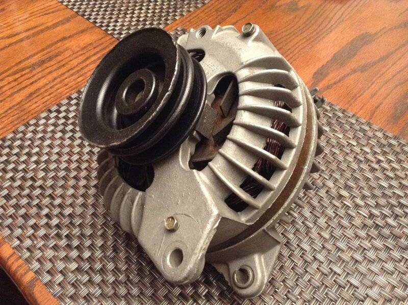

Here's the one restored. I am waiting for the one they put brushes only in to take a dump before I install this one. It was really nasty with 50 years of crud on it and no longer working before I took it to dave and he totally rebuilt it. bearings diodes yada yada everything replaced. Look at it now! Me likely!

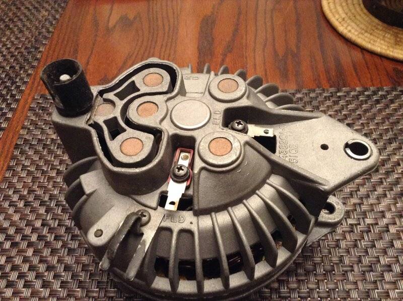

Another pic. i wouldn't shout him out if i wasn't impressed with the value and workmanship. thats two alternators for 50 bucks including tax. he even found a double pulley and installed it on the other one for me. it was a single pulley and i needed a double for my air c
A 1967 would use a one wire field and not a two as in picture. If you don't have A/C, then you probably want a single pulley. Diodes rarely go bad.

Right on! a post with pictures thanx!!
And if IIRC a dual can have a different ratio than a single pulley. So that can really change performance - not always for the good.
I had one local shop (whom I'd never recommend assuming he was still in business) do a swap to a pulley for a large belt to keep the ratio (maybe?) but make it less likely to fly off. That's the sort of quick and dirty things that can be done to fix problems. Of course doesn't always make it right or good.
One of my cores (from 1990) was on the car when my dad passed away. It worked fine but was a 2 pulley. The charge indicator bounced a lot at idle.
I replaced it with a single pulley ( the one the last failed) the charge indicator did not bounce at idle.
Difference... 2 groove was 3", 1 groove was 2.7", parts book calls for 2.5". It would probably charge with the headlights and brakes on at idle with a 2.5".
The square back I bought for the time being, bounces at idle... 3" single groove pulley.
So size does matter and sometimes smaller IS better!
