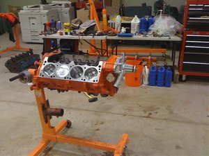

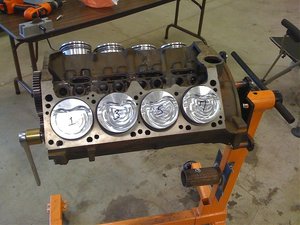

Here are the IC745 Forged Step Dish Pistons I am using in the 318/402 I am working on now. They have a 20.5cc Dish in them with 62cc heads and a .039 gasket compression comes in at 10.20 static and 8.73 dynamic at zero deck.
