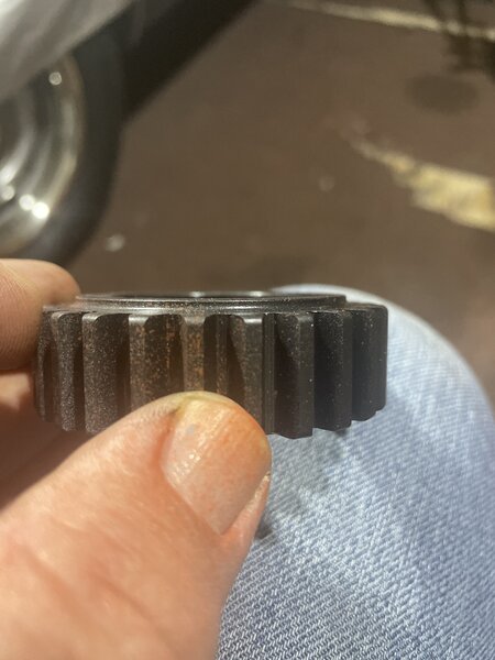

Thanks, like so, below then … it seemed to have the crank gear not fully engaged to the idler sprocket. I wasn’t crazy about the offset.

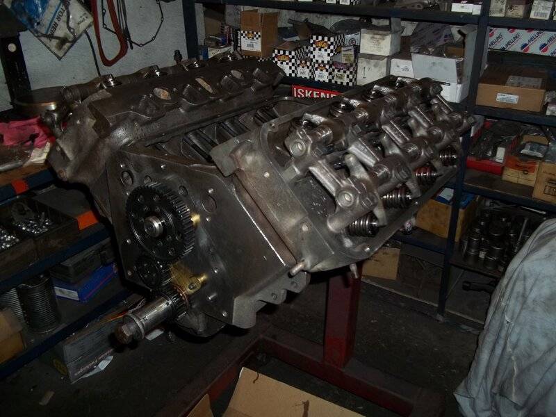

Will you still be able to install the oil slinger - or will it hit the idler? I bought the big block version for the 505 im building, and am wondering about being able to use the slinger.
Rumbel, flip it over and take a pic of the other side. I don't see the chamfer/ radius for the crank snout in your pic.

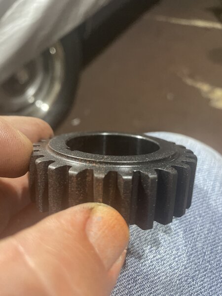

I’ll have to agree. I think the oil slinger is out. Everything is a bit tight for the slinger, *I Think* anyway. To the point I’m not going to bother, but I’ll try because you asked. Maybe????? It’ll squeeze in behind the gear. Here is a back side of the gear shot for you.
IMO, as I see it, if the slinger can be installed, it’s just dripping oil on the back side of the gear. Which is solid. The holes in the sprocket would allow oil out but it would be to nowhere up front.

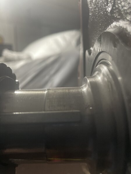

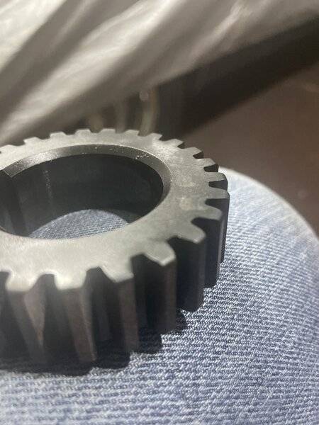

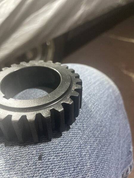

The bottom gear will have a chamfer on it to fit that radius, flip it over.
Ahhhhh HAAAA!
Now that I’m in the light…. Not daylight…. Brighter garage light,
I SEE THE LIGHT!
That ought to line up the gears. I did t see it in the daylighting inside the garage. Thought it was just flat across.
Since I never had one of these before and installed it with the raised chamfer towards the crank……
Darn thing was a minor PIA to take off being a nice and fresh gear and crank. That lively pressed fit thing….
