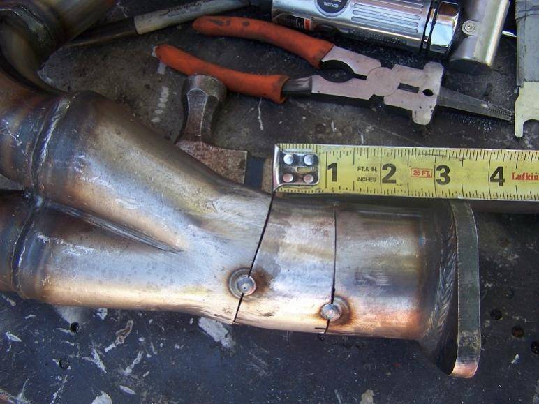

Just curious, how much or what had to be done to make the clutch linkage clear these..?? I reworked a set of headman 78030 for a low deck stick set up. 71 swinger. Took a number of in and out of the car sessions but came out pretty good in the end. Manual steer though don’t think ps would go at all. Passenger side was pretty much a bolt in..Swingn’
Here is what I did, just needed to straighten out the collector end a bit to run parallel to the torsion bar, so simple, I don't understand why Schumacher doesn't incorporate it into their design. My little angle insert was almost too long, If i was to do it again, I would shorten it a half inch or so, but it worked. Made it more difficult to install if I remember.
Nice…!! Thanks for the info..My guess is their connector pipes would no longer match up.? Then they would have two sets of headers and two sets of connector pipes..?? Probably too many part numbers to keep it simple..Thanks again for the photos..Swingn’
