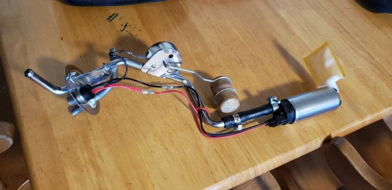

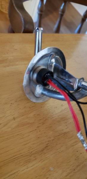

I pulled out the sending unit, found a short where the fuel sending sire passed through the sealing flange of the sending unit and made some modifications. I figured someone may want to do this some day, so here are some pictures of the modified sending unit. I left the soldered connections bare because I didn't have any fuel proof shrink tubing. The wires bolt to some style of fuel pumps, so I figured its safe once installed.
I used real silver solder I found at a welding supply shop after finding the common hardware stuff ineffective. I sourced the bulkhead wiring connector and my surge tank from Radium Engineering. They make the best quality parts that I've found and are considered top shelf by the Tuner community.
