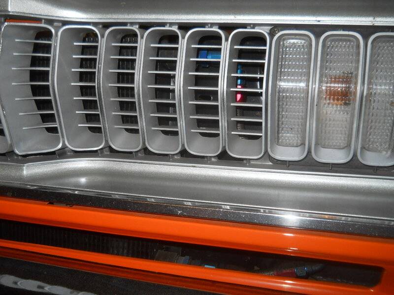

There were different sharks tooth grilles. Some were molded in black and painted silver. There was no blacked out fins. Otheres were molded in silver and blacked out.
Here is a grille out of a 71 Duster that was a v24 car with no black out on the hood originally. Note the grille is as it was from original . Molded in black Painted silver.
The brown car molded in silver and blacked out just like the orange 72 car next to the 71. I had several grilles through the years all years and even new .The molded in black grilles were always stronger with no cracks from the trim screws. also had different screws.. Just some info for all

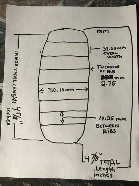

I measured the grill as best as I could with it on the car with my dial caliper. This is what I came up that hopefully isn't too confusing. Let me know what you think. Thank you!
Get ma a photo of the same spot in the car
BTW I'm ambidextrous when it comes to units.
Also if there is curvatures we will have to figure out a way to get that to me.
You might have to make a cardboard cutout that procusly fits the shape.
Lastly I would need to know what you want covered and what you want open
