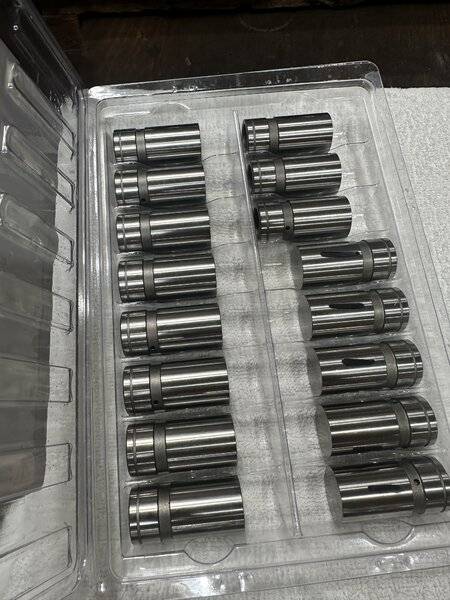

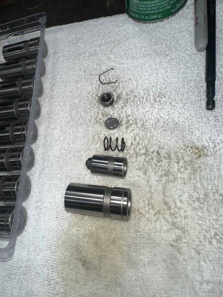

I’m sticking in a cam in a 318 this weekend and I’m cleaning parts in preparation. Needed a set of lifters and decided on Howard’s 91711. I disassemble and clean any lifter that goes in an engine I put together, and I just finished these. Gotta say, other than some light machine oil, these were damn clean and all of the check valves passed my suck test. Every single one measured .9035. Nicer than a lot of other brands I’ve taken apart.

I particularly like their grinds, because they have a lot of lift per a given duration. That favors the Chrysler .903 lifter diameter greatly.
I used the same lifters with one of their cams in a stock 340 a little over 2 years ago. I didn't disassemble the lifters. The engine was running great before the change so I made sure everything went back together exactly the same. Break-in went smoothly and I have since put on about 5,000 trouble free miles. The lifters do bleed down so they clatter until oil pressure builds.
@TT5.9mag, very interesting. I have never checked new lifters. Maybe I have been lucky? Have you ever found a bad one?
Bad is not how I would describe it. I have found stuck check valves, and junk from machining. Mostly stuff I wouldn’t want in a clean, new engine. I did return a set a long time ago because the lobe contact surface was marred up on a few of em and I wasn’t going to chance it. If I remember those were Melling stock replacement lifters.
