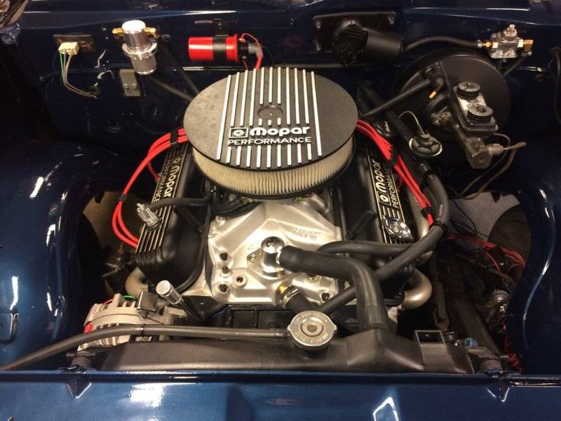

Notice the red, white, and blue in the Mopar. Nice.View attachment 1715149755 View attachment 1715149756 View attachment 1715149757 View attachment 1715149758 This thread is eye candy for the soul...

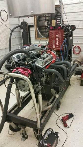

My new 340 on the dyno last week, made 442 HP corrected. Will be put in my 67 Barracuda in the next couple of weeks, I will update with a pic when installed.
.030 over boreCan you post the engine specs? Thanks
.030 over bore
10.5:1 compression
Comp roller valve train
Stock crank and rods
X heads that have been race prepped
Ported Edelbrock Performer and 750 cfm carb
MSD ignition

Any chance ,on specifications?My new 340 on the dyno last week, made 442 HP corrected. Will be put in my 67 Barracuda in the next couple of weeks, I will update with a pic when installed.

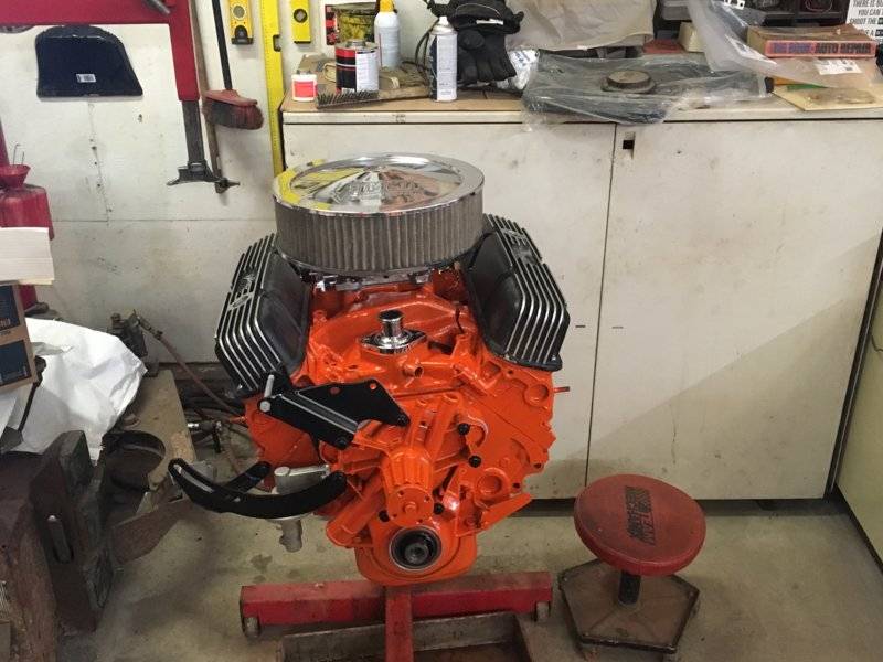

Our work in progress.
1983 318. New bearings and gaskets. 214/224 .444/.466 on a 104 ICL cam.
Holley street dominator intake and a Holley carb.
Factory early a body exhaust manifolds.
Paint to come
