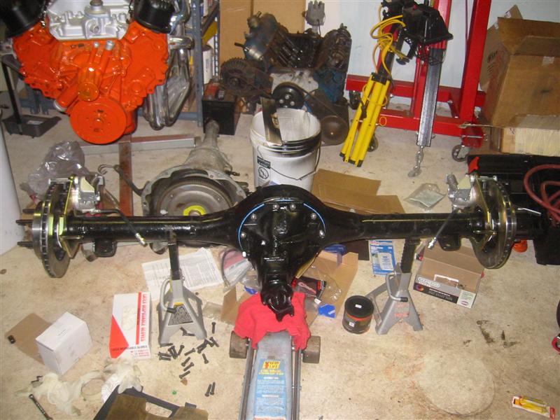

blackace The KING of flats Joined May 25, 2005 Messages 681 Reaction score 14 Location New Joisey Sep 29, 2008 #1 I am doing a little research and would love to see anyone who has rear disk set upon there 8 3/4. Here is a pic of mine.

65 Dartman 1 of None 65 Dart Sedan Delivery FABO Gold Member Joined Sep 24, 2006 Messages 13,718 Reaction score 4,557 Location Strasburg, VA Oct 6, 2008 #2 Where is your kit from? I'm considering going with the one from Street Road manufacturing (http:www.tsmmfg.com) for my Dart wagon.

blackace The KING of flats Joined May 25, 2005 Messages 681 Reaction score 14 Location New Joisey Oct 6, 2008 #3 That's a scarebird adapter. Not a bad setup but it will hit the springs. So a spring relocation kit is necessary. They could work with maybe redrilling the flange pattern. They would need to be moved about 10 to 15* upword.
