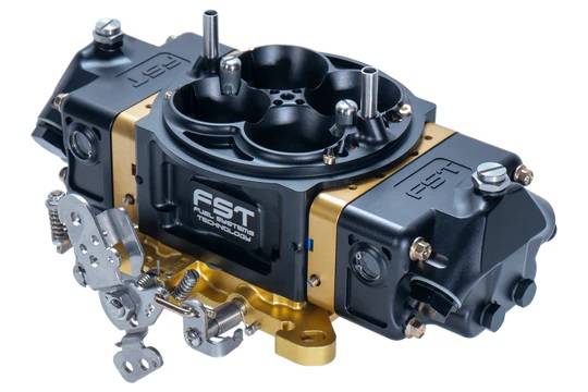

Another update, I managed to score this FST billet extreme 850 carb, so next piece of the puzzle is there. Now to wait for parts to arrive here....
