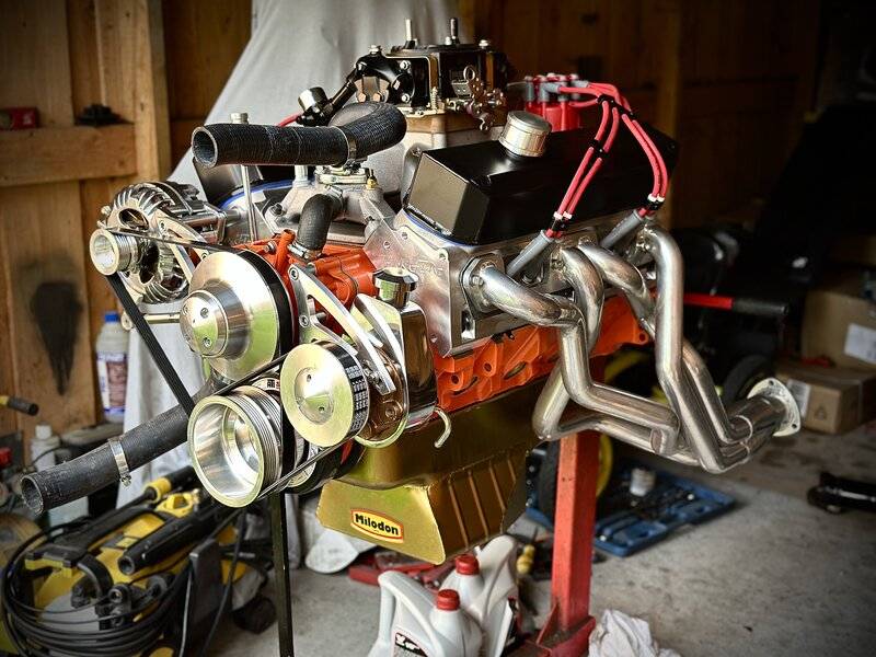

Engine is done and in the car. I took some photos of the thing in my shed before installing. just waiting for new cluch to be able to start it up.
