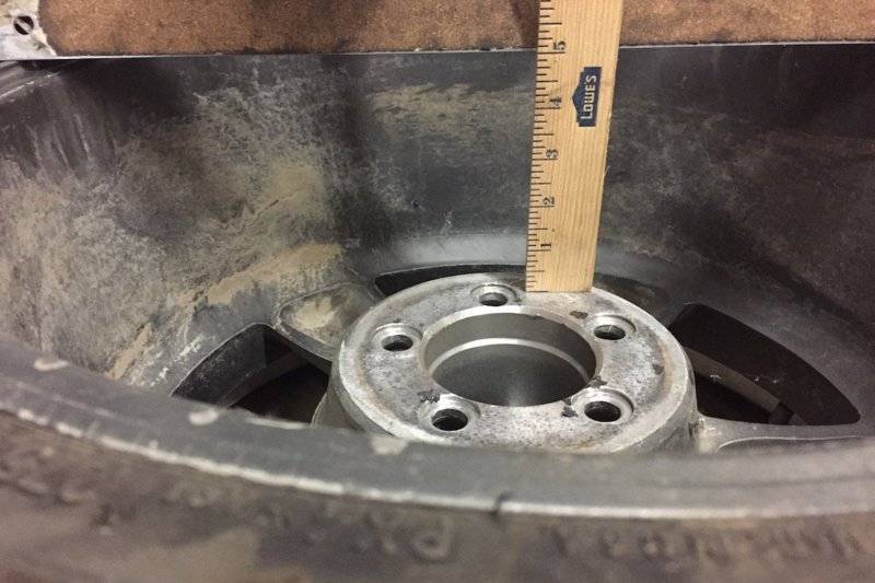

This is all great information and I appreciate it. Would you happen to have this information with visuals present? I tried googling but they’re not all the same so it’s hard to know which is correct.
Sure, here’s a diagram
Couple pictures of how to measure backspace, 17x9 rim, zero offset, 5” backspace
