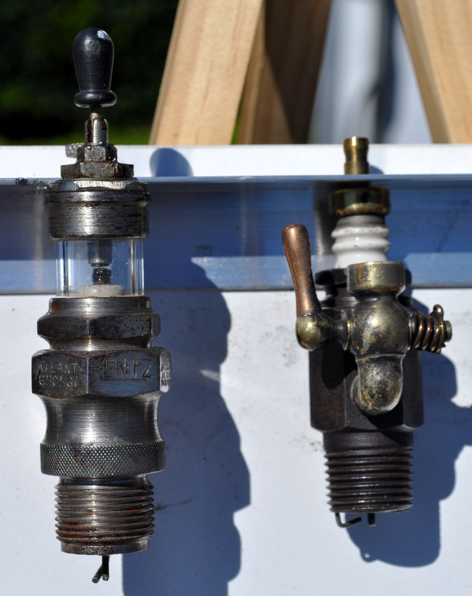

Probably like these -- fits Model A Ford or model T. These appear to be pipe (tapered) thread.
There was all kinds of quirks and gadgets ........one of these has a fuel priming cup
