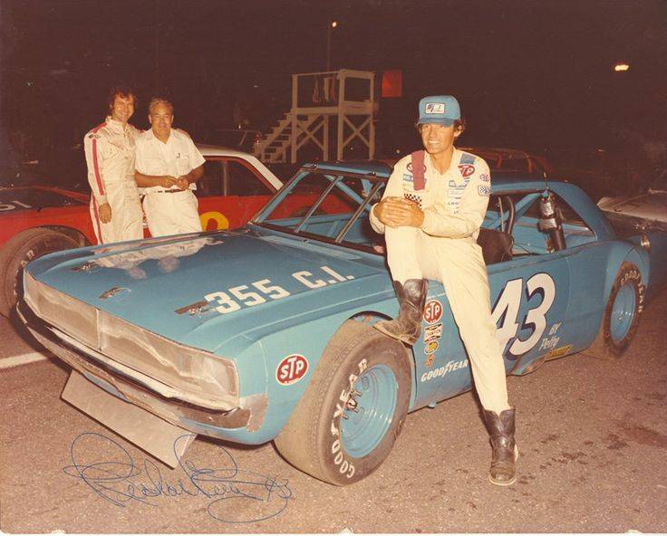

Thing is, you'd have to cut the fenders too, similar to the Petty car (maybe not quite that much). No different than hanging the tires out past the quarters on the 70's street freak style drag cars. Once the tires are out past the body, you have to make sure the body and the tires never occupy the same space. So, you either raise the car up (like the street freaks with the crazy lifted rears), or you have to cut the body back. Whatever suspension travel you have is how much you'd need to cut out. So, that would mean cutting a couple inches of fender out all the way around the tire, to make sure the tire never hit the fender on turning or with suspension compression. Then you'd put the flares on, making sure the flares were wide enough to cover whatever amount of tire you added, plus clearance just like for the fenders.

Like the "Fish Tail" drift car, except you'd need bigger flares up front and you'd lose more fender than that
