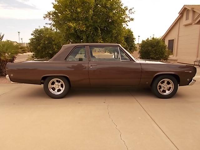

After messing around with different combos I got the stance and ride I wanted
what wheels are those? size? they look like the ones i got from Darter6 in the deal for my valiant, but i don't know what brand they are... car looks goood
They are a Halibrand replica 205/65-15 and 295/50/15
Front is too high, imho
The a$$ of the car was too high for me so I raised the front and still had to much rake for my liking. When I moved the springs inboard for the mini tubs I had 2 sets of holes for the front bushing so I moved them up dropping the rear to where I wanted it. It transferred weight to the back so it rides nice and hooks better.
I like it! That's exactly how I want the Dart to sit when I get done with it.
I don't know about the small pattern but JD Wheels on e-bay sells them. I'm sure they are Chinese though.
These cars when new were not "*** high" I think that thing looks like DYNO-MITE!!! Great!!!
