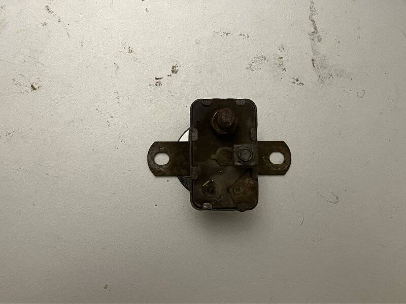

Look at the original relay, generally early manual trans relays have the missing terminal actually still present but instead of having a external wire connected it connects to the case like this one...
It was somehow mysteriously grounded and lost its ground I bet.
Yup and I "just bet" that the mounting points got dirty enough that it lost the ground. OR that little bit of solder melted.
Notice when I mentioned 'early" well on passenger cars that year was 69...In 70 they started using a clutch safety switch...
But your truck just by being a truck might have been enough to not get the extra safety but being a 4x4 it definitely doesn't get one, with a 4x4 when your in rough terrain guys will intentionally start the truck in gear with the clutch engaged to help get out of a "sticky" situation...

I now see that grounding plate.
I thought that it might have had a spade on it that broke off but it looks so cruddy, it wasn’t likely. Now looking closer, it looks untouched, maybe original?
Kooky.
Thanks again!
If you have the spade connector on your new relay you could run a wire to the NSS on the automatic trans (middle terminal IIRC) and gain a bit of safety. All it does is make the ground path when in Park and Neutral.
