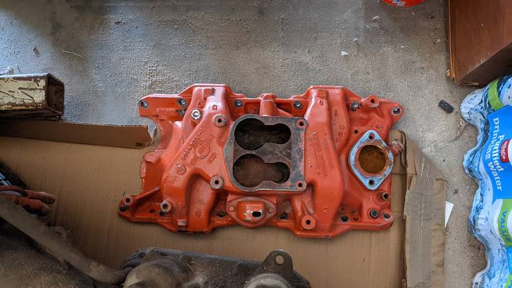

no i have a 340 high rise one that the guy threw in with the engine and trans because I am a SHREWD negotiator.Were you looking for a 4 barrel intake? [FOR SALE] - 1966 273 4bbl intake
That's a damn good intake. It will work well.no i have a 340 high rise one that the guy threw in with the engine and trans because I am a SHREWD negotiator.
