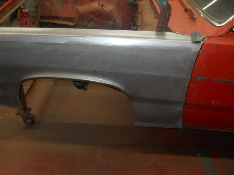

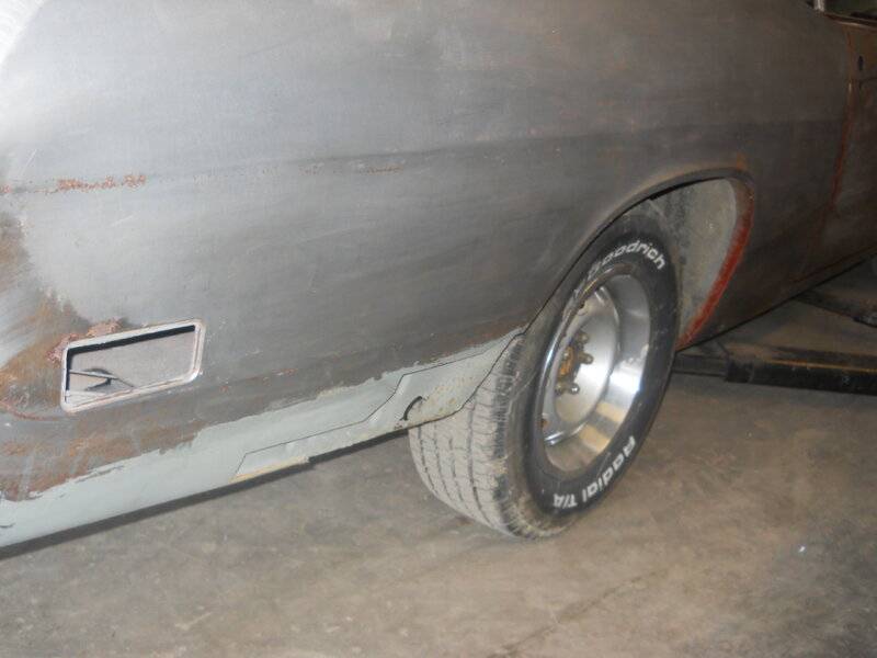

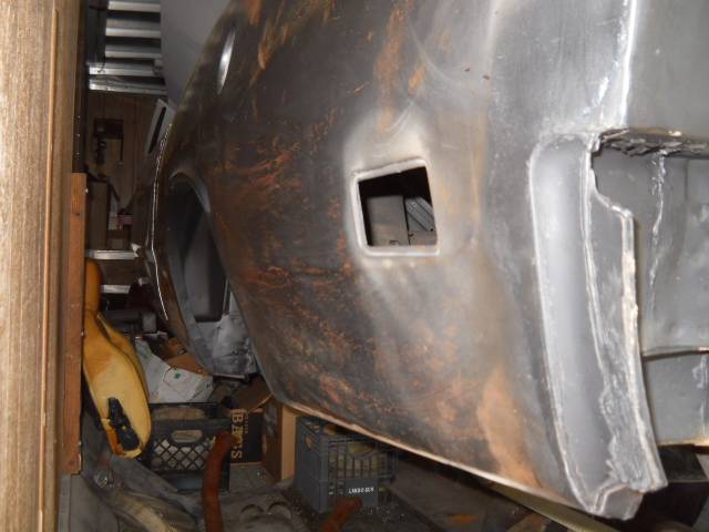

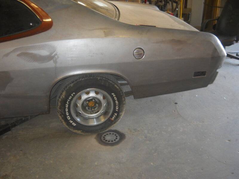

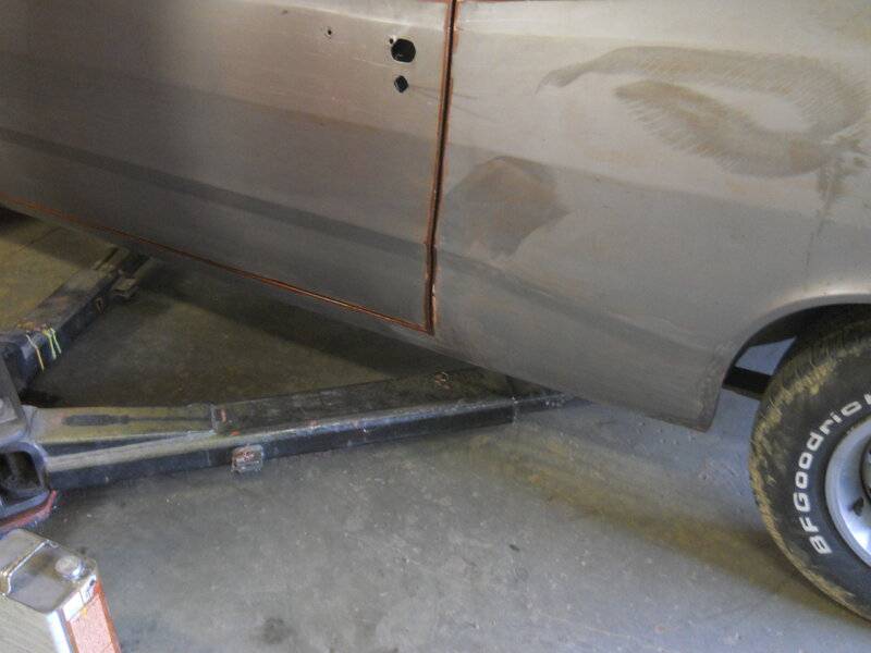

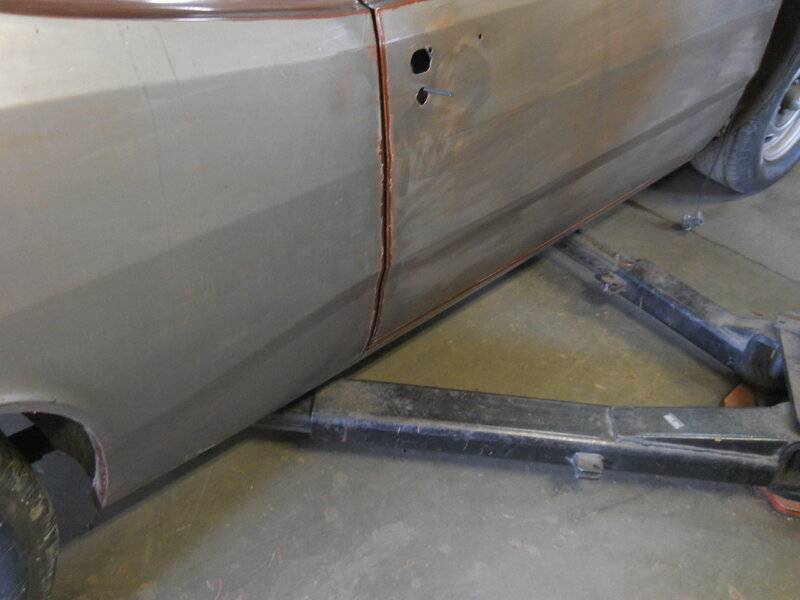

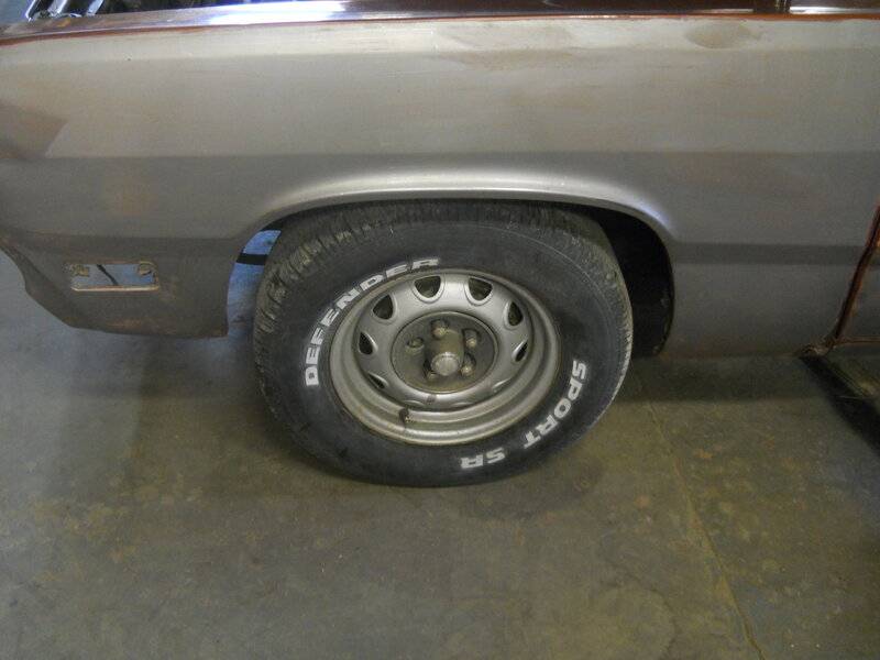

I use the cheapest stripper you can get at lowes. Brush in one direction and let set the cut what you can off at an angle with a single edgs blade then re brush. Once your primer, Brush again and then use coarse steel wool. make sure to tape all seams and never strip to the edge. I refuse to sand paint off panels. With stripper you see whats under the paint the brown car that was factory paint. look at the grinder marks underthe primer. There was also bondo under the factory paint filling small dents. You won't see this if you DA the car. Also DA's make heat need I say more. I included pics of an orange Duster also. I paint strip everything even fenders that I repair.

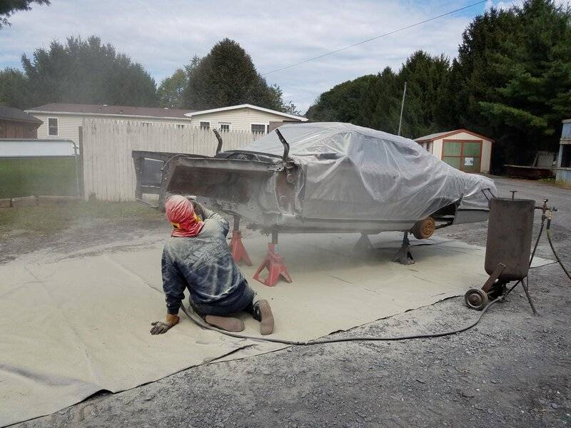

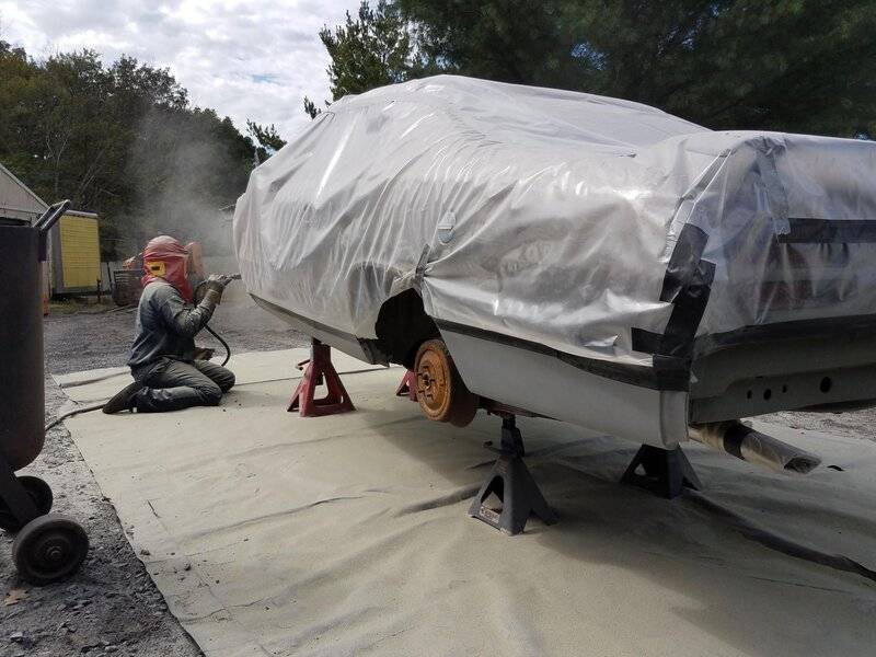

Aircraft stripper is crap . I think you're money and time ahead by having it blasted . You don't have to use black beauty , per say . there's walnut shells, rice hulls , plastic pellets and other media that won't warp the metal . A real pro will know whichto use .
The down side of blasting is the media keeps on flowing out years later. Ask me how I know. Blasted it in 1983. bought it back in 2010. The trailer was covered in media from the trip home.
Ah yes. The dreaded black beauty run off. I had to blow my shell out possibly 20 times before I laid primer. Once prime was on it locked in the sand. By that time the stuff was all out except the rockers. Those places held sand for months to come.

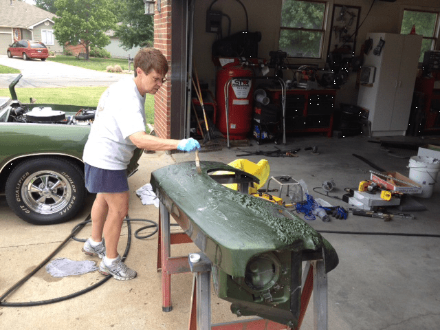

Here is my $0.02. If you are completely blowing the car apart, I would (and did) use paint stripper. As you can see, I had some really good help! If the car is going to be completely disassembled, the parts could be thoroughly cleaned off and rinsed; leaving no problems for the future. If you don't completely disassemble the car, I would not use stripper. IMHO, there is too much of a chance that some of the chemical could hide in a nook or cranny and cause some unpleasant problems later. Then, I'd go with 80 grit sandpaper on a DA. Lots of 80 grit. I see people using a sanding disc too long thinking they are being wise and frugal. "This sanding disc is still cutting OK. Too Early to change it." If you use the disc past the point where it is cutting well, you are wasting time. When I feel the disc is no longer cutting well, I put on a new one. It may cost a few bucks more, but it will be faster.

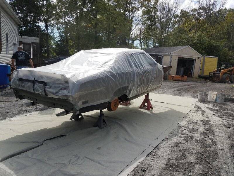

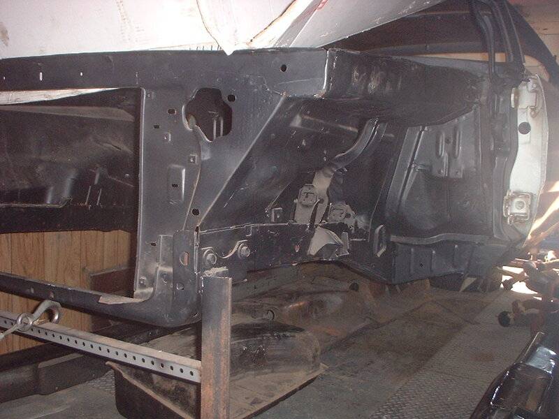

One other ting is that a sanded car will rust when taken to bare metal. A paint removed you can leave set for years and no rust. This Demon below was stripped in 1999 aftre metal prepped it sat in a trailer since. It only has surface rust where it was touched. fingerprints? You can use this info or not. Most body shops have one thing in mind get it painted and get paid. Its not their car that they will be looking at in years to come. Never paint strip any seams.

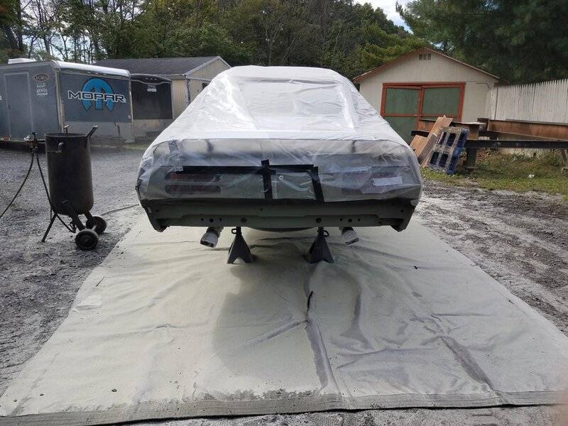

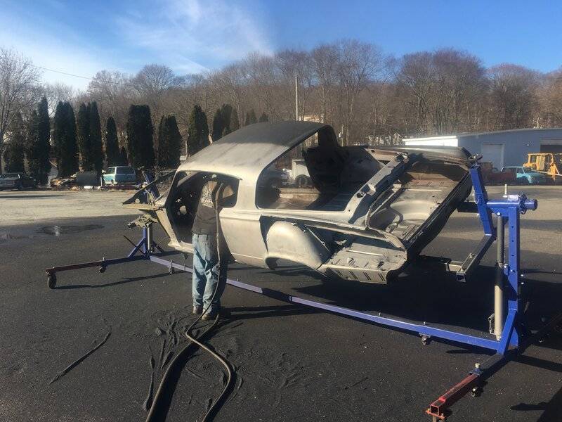

I only Paint strip the outer sheet metal the rest is media blasted to remove the rust. Never blast the inside of the roof or quarters. if you do the panels will warp. I always blast the rockers and lower body after paint stripped to remove and small rust pits. Then apply Acid and then wash prime. then primer surfacer. Good luck on your project.
