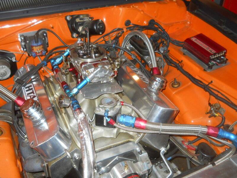

410 stroker, with Magnaflow fuel system, Pro systems 850CFM car, MSD Digital 6 plus ignition with billet distributor.....
The car is running clean up to 6000 rpm, after that the engine starts to struggle " kind of misfire".
We have changed fuel jets, spark plug gaps, changed plugs. But nothing seems to help.
Even when we close the gap from 0.045" to 0.030" it when worst. The car starts bugging completely down after 6000 rpm... I have the feeling it is somewhere in the ignition....
Any help will be appreciated

Here's a couple of wild guess's.........you are running out of gas, need more volume to the carb or valve springs are weak
Our 416 has seen 9000 with out skipping a beat. Sounds like you have a valve train issue. We run a billet with a digital 6 and a 1050. Check all your grounds get race plugs and a coil that is 6 and 7 approved.

WHat is your fuel pressure at WOT?
What is the AFR at 6,000?
What is your top end limiter set to?
What ignition are you running?
WHat is the LSA?
What is the timing at 6k rpm?
If it runs into the wall at the same rpm point in every gear, it’s likely a valvetrain control issue.
Are you running a hyd cam?
What is the limiter set at? They come in pretty early. What cam! Hydr/solid? Status of springs? Age? AFR gauge will cut down on the possible causes. If its lean, fuel supply. Rich, could be ignition. Varies considerably. Valve train. When I spin mine to 6700 it just stops pulling. Doesn’t act up, just no power. More info needed
Might be your ignition box. If you have a friend with a working box see if you can borrow it for a few hours to test it out. Also, I have heard stories of these boxes having issues with the rev limiter functions....try turning them off for a pass (just don't launch hard incase you snap a u-joint and zing engine).
