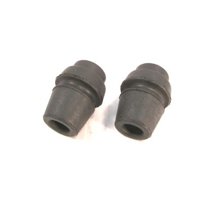

Hi,
At the moment I'm working on the rear end. After I complete it I'll jack the front up again and change the poly's for original bushings. PST sent me the original kit by mistake and then the poly setup, so I have them on the garage (don't see the point ordering the 3rd kit).
As much I have read from different forums that's the way to go (or the moog upgrade kit), some have said that after installing the poly bushings they didn't get the front alligment right. Also some say that the start making strange sounds etc.
So these are going in:
I hope they work ?
