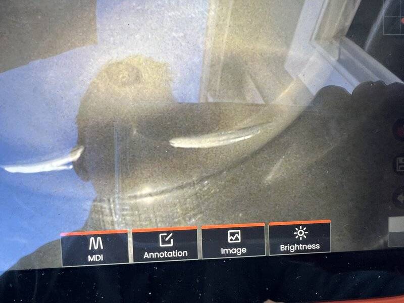

No compression on 4 cylinders. Valves touched pistons on 6 cylinders. 2 survived. Must have floated the valves.
Not sure how because I have a pathetic 8.5:1 compression. A .039 gasket, pistons were down the cylinder .047” and my cam isn’t even that large. Barely .5” lift
That's an interesting development. Can you check timing chain slop?
"barely .5"lift" seems pretty huge, no, humongous especially considering what these engines originally came out with I've seen timing chains jump on stone stock engines where the valves kissed the pistons
I had it happen to a Durango, 360 mag, brand new EQ heads that were supposed to be ready to run out of the box, but they had the guide clearance too tight, a couple of valves stuck on break in
(Stone stock bottom end, original cam it left the factory with still in place) and it bent a couple of valves on me
Maybe but I have doubts. It was a strong double roller and I had a v6 tensioner. I’ll check for slop.
Cam is .490” 218/218 115 Lsa. Fairly mild cam. I think I floated the valves. These are EQ heads. Have about 2000 miles on this engine. Zero issues.
