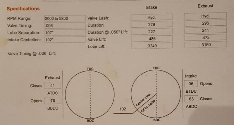

Cam specs below.
383 is fairly stout, aluminum heads, headers. I don't recall the specs on the heads or pistons.
I have been driving it with this combo for many years.
First with 390 Holleys, it made 440/461. After a few seasons I switched to 600s and there was a noticable difference.
This past year I upgraded to efi, and after sorting out a fuel pressure issue, it is definitely a different animal.
Also, the slight hesitation at times with the tunnel ram and 390s was evident, different with the 600s, non-existent with the efi.

Cam specs below.

your cam is on the money to make a nice streeter with 3.91s and 27/28 inch tires.
