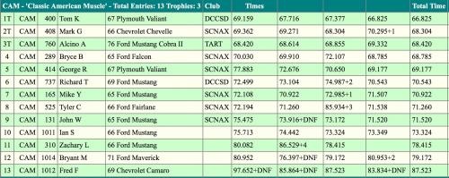

This is what 285 front and 305 rear look like, winning last weekend...
attachment.php
i'd like to see those CAM results compared with the rest of the field. Say a newer Mustang in ESP or anything ESP or even C, D, F stock.
and yes i need more tire. I'd like to go to 255 or so on a 17x9. I've become a convert of not overtiring wheels.
