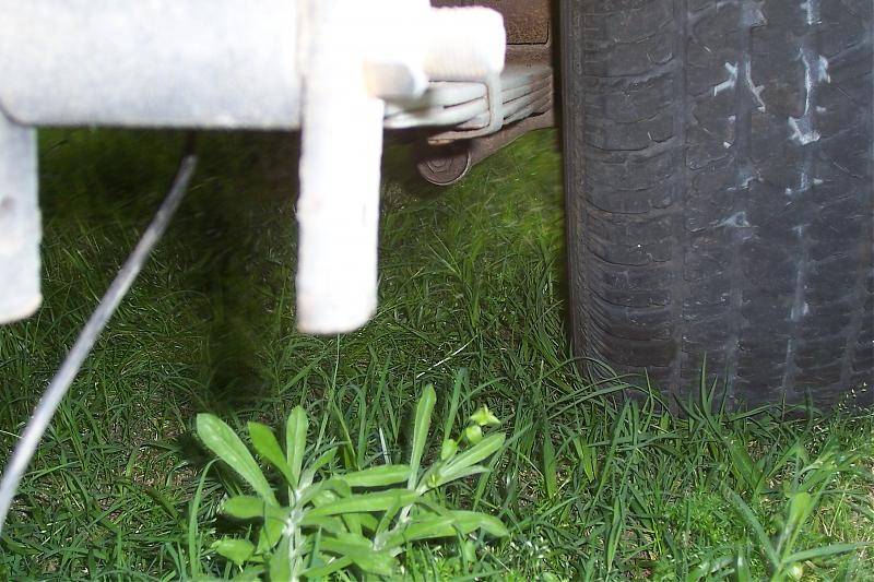

my tires are hitting the springs with the 275/60/15 wth???

Offset spring hangers would be the best solution. Moves the springs in about .75" per side. You have to have new perches welded onto the axle tubes & do a bit of grinding on the frame rails to make the front hangers fit. Another solution would be to use wheel spacers, if you have the room at the wheel lip. Not as good but works in a pinch. They're easy to find in the 4.5" bolt pattern.
Do you know the back spacing ? 15X8s with 4.5" usually fit but every car is different. You can use a thing spacer to move them out a bit but make sure you have enough wheel stud threads in the lug nuts. Other wise you will start breaking wheel studs.
acutally they dont hit. They barley clear though by like .5 to 2 mm
and they clear on the left more then on the right

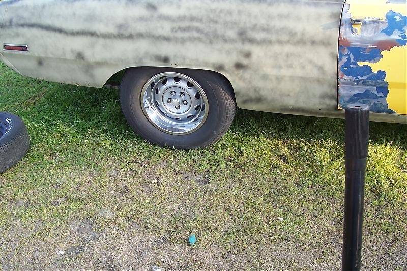

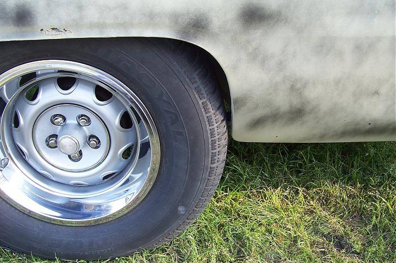

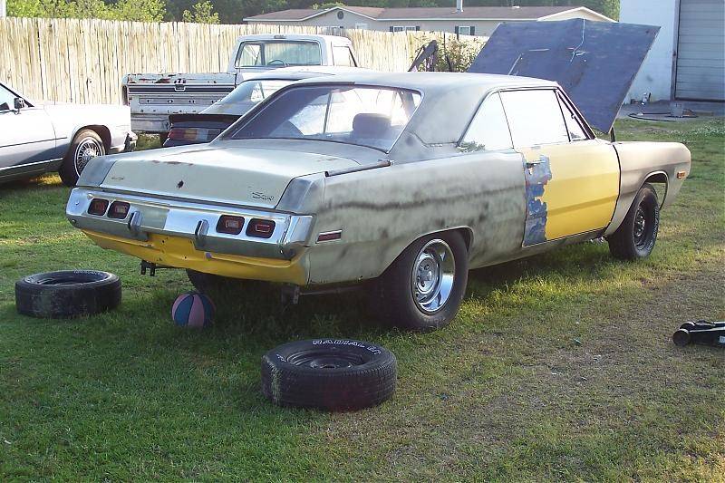

How about 255-70-15s on 15x7(i think)with unknown back spacing,but im gonna find out in a few days.Theres about a 1/4 inch gap at the wheel lip,one inch between the springs.The front of the wheel opening at the bottom is a little closer than i like,so im gonna move it forward about a 1/4 inch but keep a factory look.Any ways,i love the way these wheels look,and very happy i got them on here now.

a 15X7 Rallye usually has 4.25" back spacing which would be a plus for him.
Spacer will work but I would use 3" long wheels studs and open end lug nuts.
