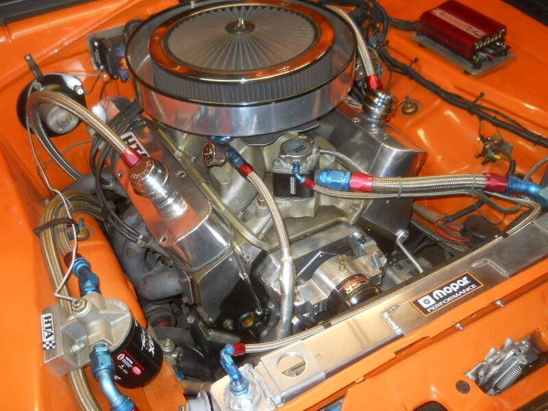

Tearing my engine down for the new build.

We brought the engine in from my Orange Duster. It was freshened couple of years ago to put in another car. We decided to to go to Higher compression and lighter rotating assembly. The only thing we are reusing is the bare Block and bare heads and the valve covers. All the rest of the parts will go on the shelf for customers builds. The engine was fresh and never fired. The rockers are 1.5 we are going to 1.6. Valves and retainers will be titanium, new pistons are 13-1 Here are pictures of whats coming out . oil pan is new. as are the valves and push rods. Timing chain and cover is being replaced with a belt drive.
